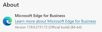

As for Browsers, I am using Edge.  And once I create this form in our Test environment, (Ver 11) and import it back into Production (Ver 10.4.5 on Windows Server 2012R2) is it fine on all forms.
