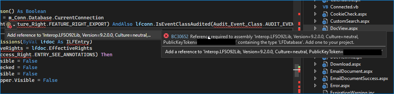

The main issue I am having is that I’m unable build the solution. There are several references to DLLs that are missing however I am using the most up to date code base and the same code files work in production so I’m not sure what’s going on.
As you can see in the above screenshot, it is complaining about an assembly “Interop.LFSO92Lib” and I’m not sure how to proceed.

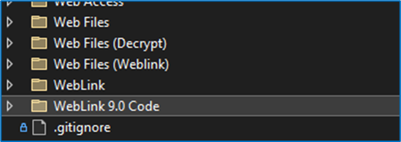

The original problem I had is that there is seemingly multiple solutions with *almost* identical code in them, and they all are called WebLink. I wasn’t sure which one it was, so I decided to bring in the code that was already in prod and start from scratch with a new repo.

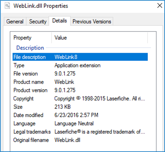

The DLL I found in production is titled “WebLink 8” however one of those solutions I was mentioning before that we have are titled “WebLink 9.0 code”, and whoever was maintaining this code before me left no documentation on what is and isn’t the correct solution. So, based on the DLL that is in production I believe it is Weblink 8, however there’s a solution for Weblink 9.0 code in our repository for this project and I’m not sure if it is related or not.
There are multiple solutions with seemingly slightly different versions and It’s left me confused.

Interop.LFSO92Lib is a component that allows .Net code to call into the COM LFSO library. It's installed as part of the WebLink installation, but if you just copied the code off to a dev machine you might not have it. I think the interop goes in the GAC, and I recall Visual Studio being reluctant to look in there for it. You might have to manually copy it out and add a reference to the project.
