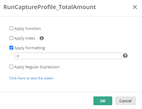

I keep getting this error with a number field on the template
The value for number field Invoice_Amount should be numbers.
But I am using the workflow numeric format code "d", what format does it expect for a number?

Capture Profile tokens are all type "text", they're not numbers.
Your formatting is wrong for numbers, it would be "d" followed by an integer that specifies the minimum number of digits you want. So "d5" would convert "12" into "00012".

replied on November 2, 2023
We never pass a token directly from Workflow to the API, we can only pass a JSON body.
But by formatting the token correctly in workflow before it gets inserted into the JSON body we can successfully use the API.
The confusion here was that I was formatting the token from an Invoice Amount token generated by invoice capture to be a decimal number before creating the JSON. The result was something like this 1,200.15
The API was stating this was not a number, which confused me. Eventually I narrowed it down to not wanting any commas, which has to be done specifically as there is no numeric formatting option for this.
