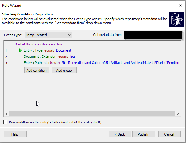

There is no error under the repository tab, but I found an error in the Events tab. The error is related to the Workflow Rule. In the Starting Rules tab, it says:
[FALSE] If all of these conditions are true:
    [TRUE] Entry Type: 'Document' <equals> 'Document'
    [FALSE] Document Extension: 'Empty' <equals> 'jpg'
In the wait Conditions tab, it says: There are no wait conditions.
The rule is already enabled for the workflow. It is also the same rule that is used in the older workflows, no change. The only change is the content types. The older workflows dealt with pdf documents. This workflow deals with jpg files (images). Please see attached.

replied on October 31, 2023
It sounds like you were importing JPGs are electronic documents before and that may have changed to import them as image pages instead. 'Normal" image pages would not have a jpg extension. Check the import settings for the user creating these documents and ensure that JPG is not in the file conversion list.
replied on November 1, 2023
HI - Do you know where do I find these settings? Thank you.
