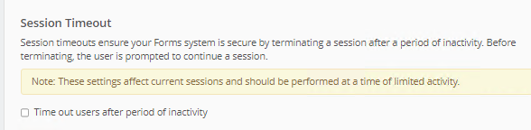

I'm not using the Session Timeout setting, so it's not that.

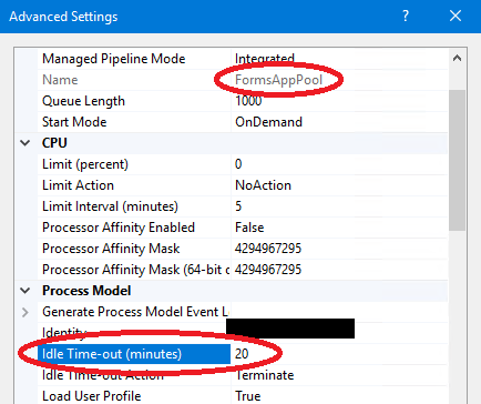

Have you checked what the IIS application pool is set to?
replied on October 26, 2023 Show version history
Thanks @████████!  I assume this is the setting you are referring to:
Does LFForms actually use this setting?  Because I found several other posts here on LFAnswers that made it sound like it does not...
