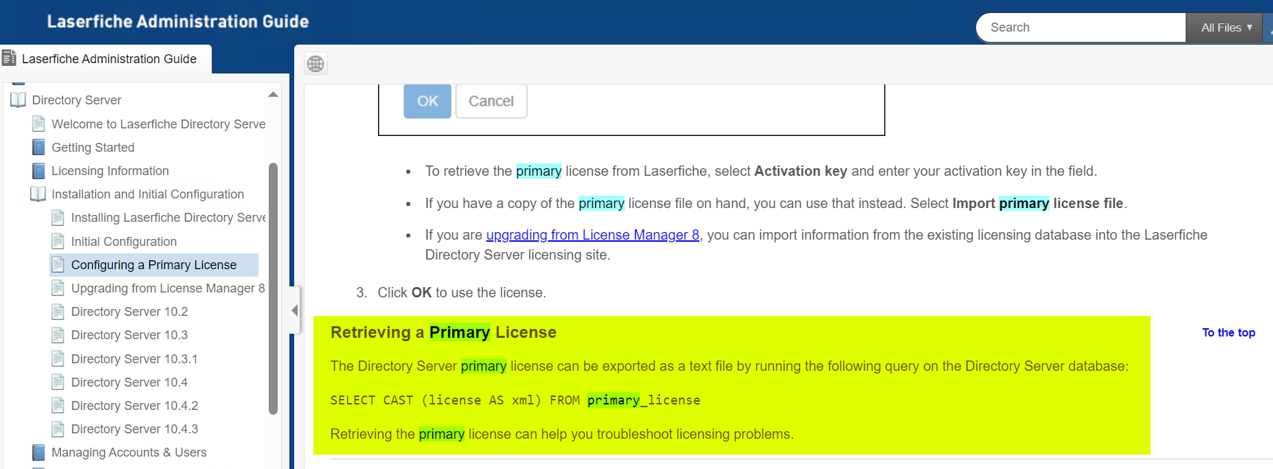

Our primary license expired incorrectly and I am scrambling to figure out how to get our system back online before our VAR and customers begin work in PST. I found this, which I believe is incorrect in the help documentation. There is no "primary_license" table nor view.
Just posting this here in an effort to keep help files up to date and share a scenario of how they are frustrating when dealing with a crisis.

I am guessing that Laserfiche did a find and replace when they changed the license name from Master to Primary. The table name is master_license.
If you try and manually update the license in LFDS does it give an error message?
