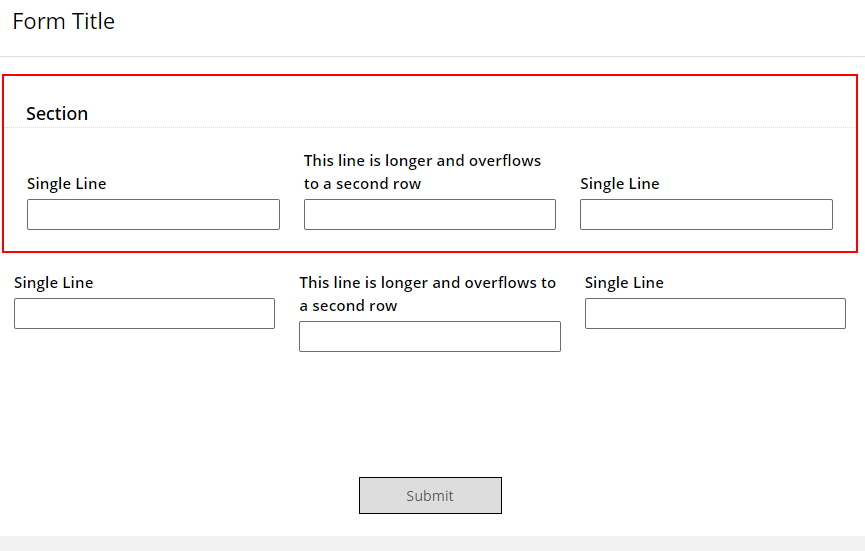

I have a case where some of the fields that sit side by side in the modern design do not align. Due to field widths some field labels are 1 line high and others are 2 lines high. I'm looking for a way to set the fields to vertical-align: bottom which I would use in the Classic Designer, but can't figure out the CSS to make this work in the Modern Flex model.

I've had some success with this, but the alignment is to the bottom of the field container, if some fields have text below and others without the input fields don't align. It would be better if the alignment point was on the input field.
.line.ng-star-inserted {align-items:flex-end;}
Found this is too generic as it sets all field in the form to bottom which gave undesired results when section were side by side, the fields in the shorter section of the form moved to the bottom as well. Can't seem to find a method to narrow this to just certain fields using classes.
I've found some success by wrapping the fields in a section and then applying similar css to the children of the section.
#q4 .line {
align-items: flex-end;
with Q4 being the ID of the specific section. This does cause the fields in the section to have less overall width but I believe that can be resolved with removal of padding on the section.
Following up with one more addition to the CSS. In order to remove the padding that the section imposes you can add the following:
#q4 .pane {
padding:0px;
where again #q4 is the id for the section.
