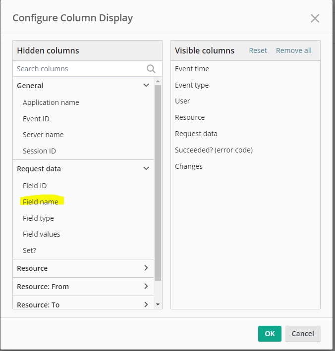

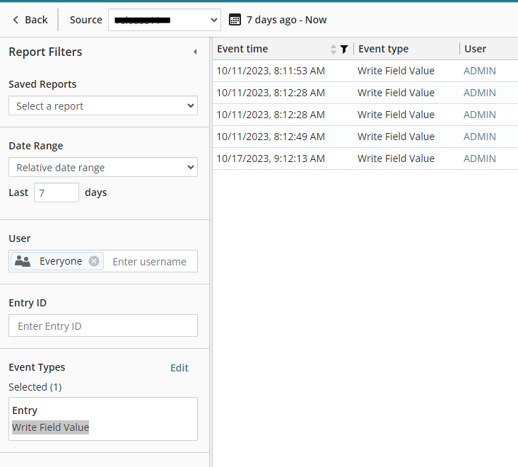

You can achieve this by following:
1. Filter event type "Write Field Value"
2. Select "Field name (request data)" from column picker
3. Filter the field name in column filter

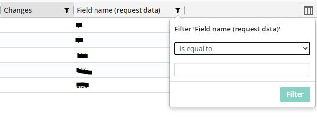

replied on October 17, 2023
Yes, the added value is in column "Field values (request data)". You can add a filter for it:
