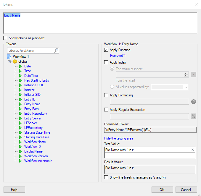

This sounds far too simple, but I'm struggling to get this working in WF11.
All I want to do is remove " if it exists in a filename.
So using the remove function in apply function like so:-
To me this should just remove the " from the filename, but this isn't working.
I could probably do this via regex or a token calculator, but function this should work, and I don't understand why it's not working.
What am I missing here?

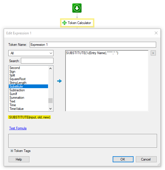

There's a way to do this currently, but it's not a "function" it's the Substitute option under Token Calculator.
Just note that the old/new values should be in double quotes, so to replace double quotes you have to escape them by doubling up the inside quotes like so
SUBSTITUTE(%(Entry Name),""""," ")
If you want to remove them without adding the space, then just remove the space from the last parameter like so
SUBSTITUTE(%(Entry Name),"""","")

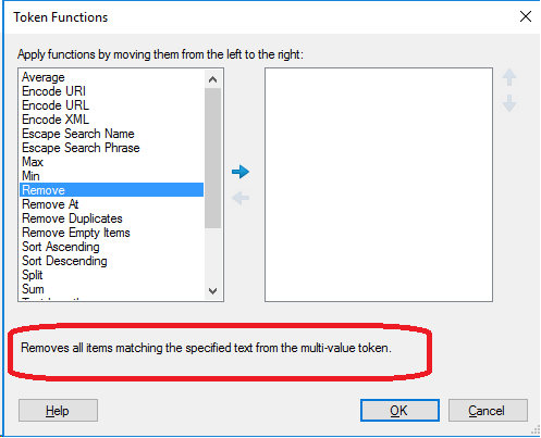

"Remove" takes out values from a multi-value token, it does not remove individual characters.

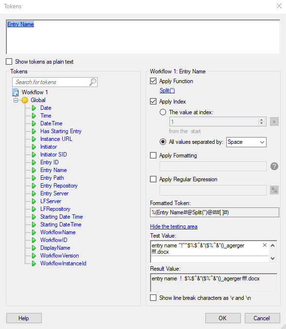

One of my colleagues figured this out, using the split function and then rejoining the token. I'm guessing it's because the remove function is only for multi value tokens, not a string as to why this wasn't working as expected.
