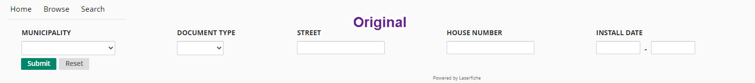

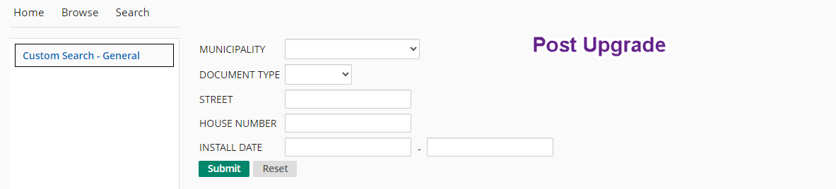

We recently upgraded to 11 Upgrade 3. Then applied Hotfix - Bug 481875. After completion of the upgrade and Hotfix the alignment of our Search Page changed from Landscape to Portrait. Can not find how to make the adjustment back to the original. Attached Pre and Post snapshot. Any ideas what was altered to cause this change?

I don't think the styling you have in the "before" picture is something you could do out-of-the-box with WebLink. Do you know how you modified the styling to achieve that layout? Maybe you linked an external stylesheet, and the upgrade overwrote that change.

Sorry it took so long for my reply. As for the "Before" style or layout it was done before I was brought onto this project. Although all of our current custom searches perform the same way. They all have a horizontal or Portrait layout.
