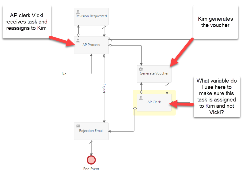

I tried using the Previous User Submitter (/_fs_submitter) variable in the AP Clerk task, but the process was suspended, indicating that the variable didn't have a value.  The last submitter had actually been reassigned by the original submitter, so I'm wondering how or if this would work?  In the diagram below, you can see that the task for AP Process is initially assigned to Vicki, but she reassigns to Kim.  Kim works the AP Process task and it routes to Create Voucher.  After Create Voucher I want it to go back to Kim.  Which variable should I use?

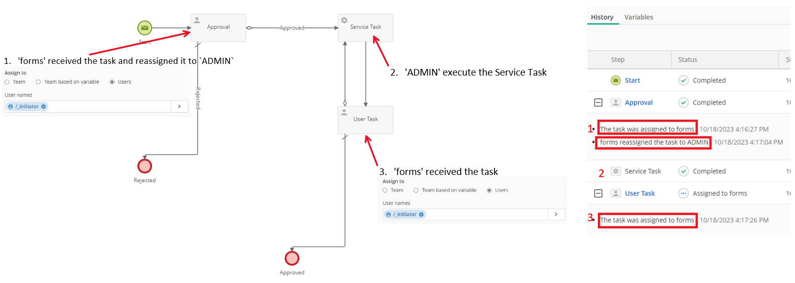

Yes, you can use '/_initiator' for the AP Clerk task. The procedure looks like the picture below when using '/_initiator'  in the provided simplified process.

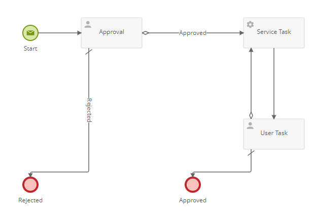

Hi Mike. I've noticed that you are using a variable value in the task. I created a simplified process like below (also attached), in which the workflow task did nothing but delay one minute.  It works fine for me: the value of variable '/Submitter_ID' in 'User Task' is the submitter of task 'Approval' and no instance suspends.
So I am wondering that whether the Workflow task changed the variable value?

replied on October 18, 2023 • Show version history
