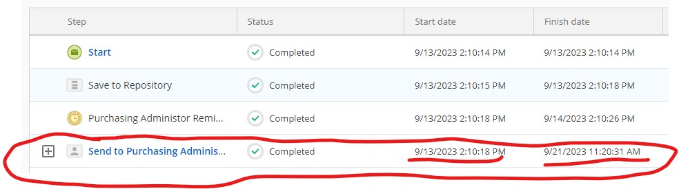

I currently have a report that I email out to a participant user not on my domain that shows the start date/time,  and end date/time along with a few other fields.  If I log in to Forms and I can click on individual processes then drill down into a process and see start and end for each User Task that had happened.
I would like to have a custom report in Excel where I could get the start and end to calculate duration of each User Task. It looks like  the table  [cf_bp_main_instances]  has the time for the process but I haven't found a table for individual tasks.

You can use table [cf_bp_worker_instance_history] to find start time and finish time for individual steps.
For example,
SELECT *
FROM [$DB].[dbo].[cf_bp_worker_instance_history]
WHERE
instance_id = (SELECT instance_id FROM cf_bp_worker_instances WHERE bp_instance_id = $BP_INSTANCE_ID)
AND
step_id =
(SELECT step_id FROM [cf_bp_steps] WHERE process_id=(SELECT process_id FROM cf_bp_main_instances WHERE bp_instance_id = $BP_INSTANCE_ID) and step_type='userTask')
replacing '$DB' with your database, '$BP_INSTANCE_ID' with your bp_instance_id.
replied on October 10, 2023
Thank you. I think I may need to make a few changes but this got me the info I needed.
