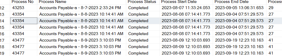

I am trying to create a report using a query from Laserfiche Workflow tables. The report I am aiming to get is one that shows how long a business process took in addition to the specific business process steps duration. The report also needs to have the name of the entry.
My challenge is how to get the name of the entry given that I cannot seem to get the relationship between the first set of tables in relation to the second set of tables.
bp_instance
workflow_reporting_log
bp_event
bp_activity_link
bp_step
So far I have managed to get the below sample report.
And
search_entry
search_entry_log
search_instance
Kindly assist.
