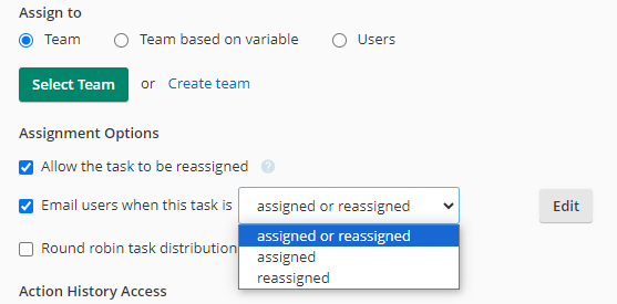

replied on September 19, 2023 • Show version history

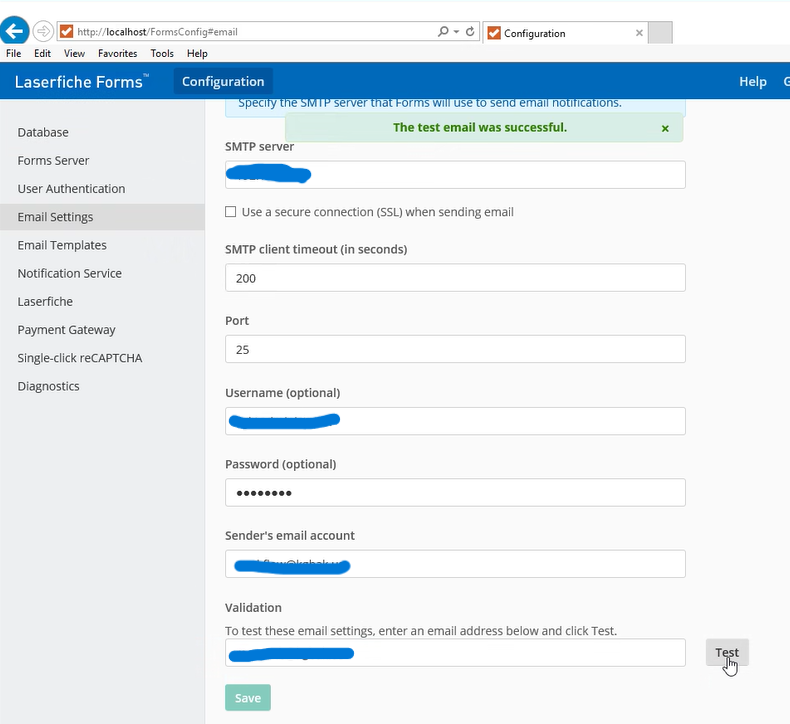

When send email to the specific user from the Forms Configuration site on your server, does the user can receive the email successfully?
Also can you double check the "Assignment Options" on user task, it can be configured to send emails only when assign/ reassign or both.

When I went to the LF Forms Configuration I was able to verify the test email was successful, but the user didn't receive an email during that test. Please see screenshot below.
I think my client has an older version of forms. Under the user's task I am only seeing the option to Email users when this task is assigned.
