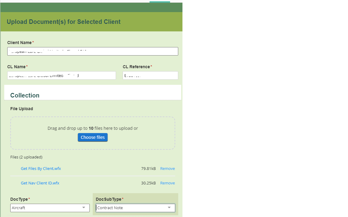

I have a form, that takes some data that I need to fill out that is used for the meta data of my uploaded document, like parent child location and file details.
I get the following error
Laserfiche Forms has encountered a problem.
Errors encountered during forms submission:
Field Name: File Upload, Position: 4, Error: Invalid attachment ID [LFF9315-InvalidAttachmentId] [LFF9312-ErrorOccuredDuringFormsValidation]
[LFF9320-FormsValidationAggregateException]
Attached is my form, is there any examples of using this control along with allocating template meta data
Upload Form.png (25.67 KB)

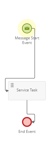

Hi, it is  a standard Form that I created with a start of save to repository service task

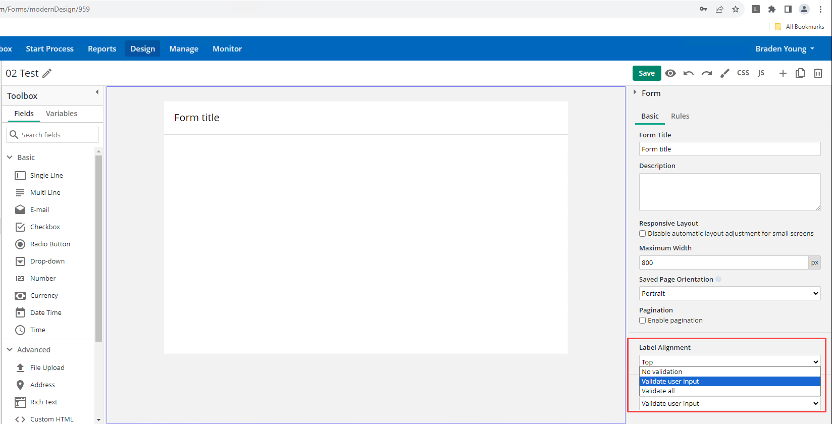

Can you confirm that you do not have any JavaScript running on your Form? Also, does this error happen when you turn off front-end validation (not recommend):
