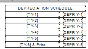

I have to use fields vs a table for data that really should be a table due the inability to format a number we are pulling in from a lookup view as I wish in the table. I want to reduce the space between the fields. I have customized the theme to lower the space as much as I am comfortable with on the form as a whole. Is there a way, with CSS or JavaScript, to reduce the space between the fields for those particular fields only.  I essentially want the space between the makeshift "rows" below to be about half as tall as they are:

Here's the other obstacle I have not yet been able to overcome when trying to use a table on this particular form. When pulling data over by using a stored procedure. See data points for each row below.  When I attempt to do this with a table, even if I have chosen a fixed number of rows, I am unable to select data points for each row, only for each column of the table. Or at least, I have not found a way to do so.

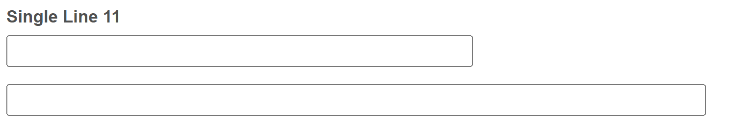

For example with display:none; I get this,

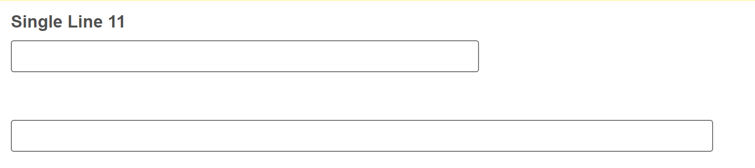

but visibility:hidden; looks like this and is a lot more like what you're seeing
The difference there is that display:none; means it doesn't render at all so it doesn't affect layout/spacing, but visibility:hidden; only makes it invisible and doesn't stop it from affecting the layout/spacing.
