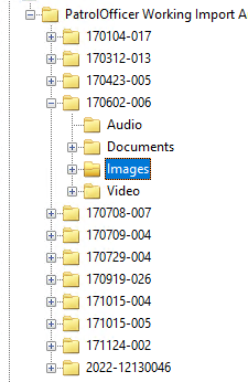

Folder structure.   I am trying to migrate everything starting with the folder name ie 170602-006.
Doing this with Migrate Entry - Starting Entry works well until the volume goes offline and then it just updates the FOLDERS ( I assume this is just a DB update) and leaves the files on the old volume and returns EVERYTHING WORKED!
When I search for files and folders contained in the Starting Entry ie 170602-006 it grabs everything beneath the starting entry and leaves it alone.   This is the search query I am using.   Is there a way to include the Entry Name as part of the iteration list?
