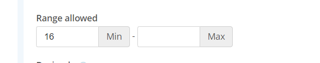

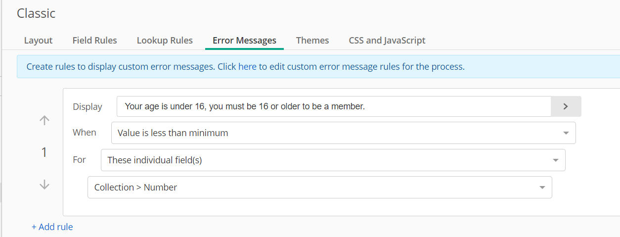

You actually can set up a validation on forms. In age field, you can set Range allowed min to 16
Then in error message tab, you can set your customized error message there when the age is less than 16. This will work for all rows in a collection

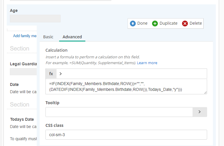

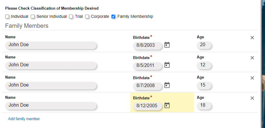

Hi Yuxuan, your recommendation is great, but forget to mention that the Age field is filled in after the calculation of a formula that counts the years that have passed from the date selected in the Birthday Date field. and is on Read-only state.
The formula I use is the following:
=IF(INDEX(Family_Members.Birthdate,ROW())="","",(DATEDIF(INDEX(Family_Members.Birthdate,ROW()),Todays_Date,"y")))
If I enter the Age manually, the error validation message that you suggest is displayed, but since it takes a formula, it does not detect, I create the event that the state of that field has been inserted or changed so that it performs the validation. I think I have to complement your solution with some detail that helps to refresh the values of the field once it is filled with the Age from the selected date or another.

Yuxuan, I have been trying to apply it but it doesn't work for me. There is a way which I think could be interesting to try, but I can't find the right way to do it.
For the method you proposed at the beginning to work, somehow the field to which I want to apply error validation must be in focus. So I think that a possible complementary solution could be to find a way that once the date field changes and the calculation is done in the Age field, the age field obtains the focus so that when the Focus changes the validation occurs. It could also happen when clicking on the Add more fields link in the collector, which first does a Focus or goes through the previous Age field first so that it validates the value and the validation of the error message can be executed.
I don't know, maybe I'm making my life too complicated in this detail, but there could be a way to solve it.
