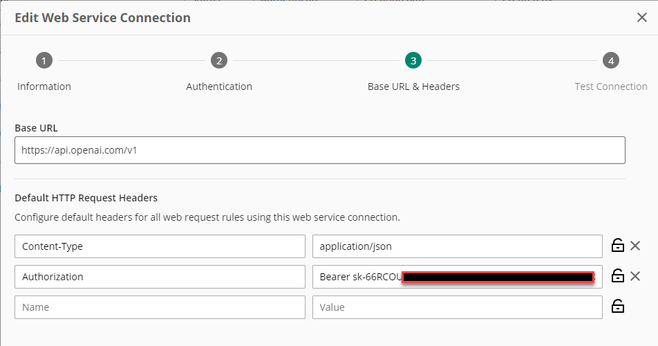

Hey Chad, thanks for your response,
Yeah I have an account and a token, I just don't know how to authenticate properly. I've tried using the token in the header but I'm not sure how to make the request work, i.e. is it OAuth 2.0 or No Authentication or what.

replied on August 21, 2023 • Show version history
I can't execute a method unless I create a web service connection first, so that's the bit I'm still stuck at. I can execute a method using postman so there is nothing wrong with the token, it's obviously just the syntax of my attempt to create the connection in Laserfiche. I've looked at this but it's not really helping me > https://platform.openai.com/docs/plugins/authentication

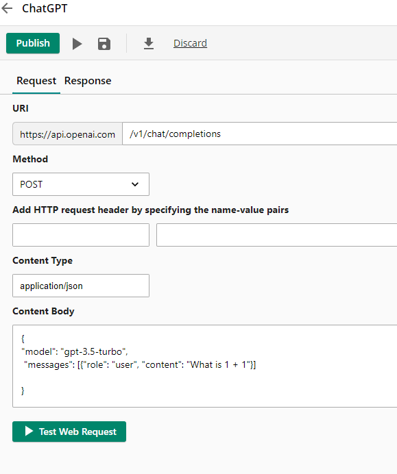

Which model are you trying to use? The endpoint can vary depending on the model. For example:
If you are using chat completions, the request body must have 2 sections: 1 defines the role and content, the other defines the body parameters. For completions, the request body only needs 1 section that defines the body parameters and the prompt.

Where I was getting hung up was when trying to create a web service connection, it wasn't returning a 200 code (returning 404), so I was concerned that without that being 200, the web request rules wouldn't work.
But ended up putting the whole endpoint in there (even though it didn't return a 200 code), then created the rule with all the json, and it worked.
So the web service connection not returning a valid result is irrelevant, something I found out in this exercise.

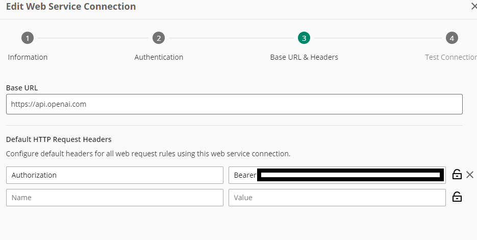

Works for me with this config for web service and web request rule
Web Request Rule
replied on August 22, 2023
Hey Chad, cheers, see my post above.
Oh yes I see, I get a 404 when I test too, that is because your not supposed to call the base URL without a method (URI and parameters), so you really can not test until you create your web request rule.
