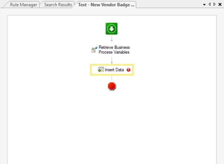

Hi, I am trying to pull in fields from a Form to an existing SQL Report via a workflow. I completed the Form Process and have now started the workflow but am stuck at what steps to take. Does anyone have an example or can list the steps to accomplish this? I currently have what is attached. Much appreciated.
replied on August 18, 2023
I assume when you say “SQL Report” you mean a table in a database.  If so, then what you have in your screenshot could work, if what you are doing is taking a single set of data on your form and adding it as a single record/row on the database table.

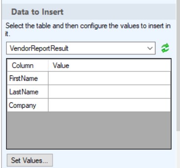

I am taking the single set of data from the form and adding it as a single row to the table. Do I still need to set up "Insert Data activity to use that existing connection"? I have the values picked (attached) with the server and workflow connected to the database.
I was stuck on the workflow itself and didn't know if what I had was sufficient to run.

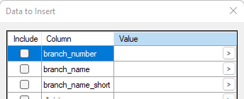

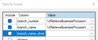

It looks close.  You just need to add the tokens from your "Retrieve Business Process Variables" activity into the value area from that last screenshot.
Click the "Set Values..." button and you should get a pop-up like this:
Using the token pickers (the ">" buttons) on the right to select the tokens from your workflow.  That should open a menu that includes all available tokens from all activities before this one.  So you should see the "Retrieve Business Process Variables" activity in that menu, and can drill into it to see all of the variables that you selected to be available in that activity.
Should look like of like this:
Tokens added - thank you for your help!
