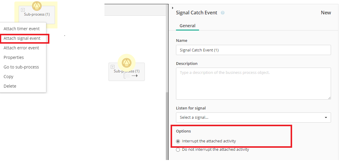

Is there a way to attach a Signal catch on timer? Whenever a signal is thrown, I want to end the timer as well. How can I do that?
replied on August 13, 2023
You can put your timer event in a sub-process, right click it and the then attach signal event. In the Signal Catch Event, you can select the signal that you want to catch and choose "
Interrupt the attached activity".
