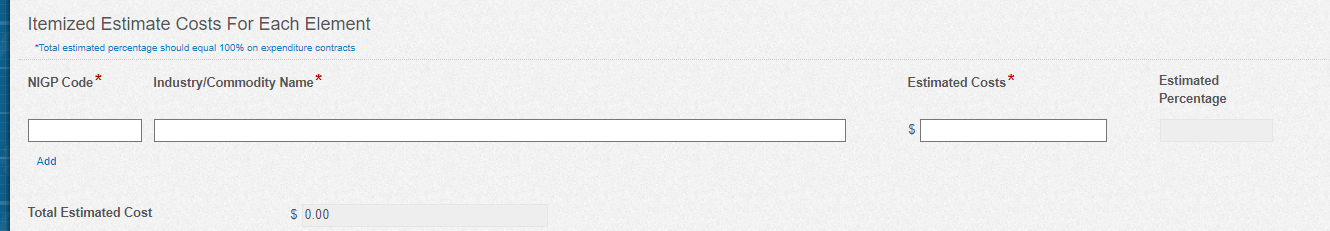

I have a use case where I have a "Total Cost" field that is populated with the total cost of a request.  Further down the form I have a table that allows the user to enter one or more commodity codes along with the value of each.
I have an "Estimated Cost" and "Estimated percentage" field in the table.
I would like the "Estimated percentage" field to calculate the percentage using the cost entered on that row, compared to the "Total Cost" field which isnt on the table.
I tried a few calculation methods and I cant seem to get it to work as intended.

Do you have a screenshot of all the fields? From your initial description it sounds like Total Cost is not part of a table, but your variables are set up in a way that indicates as though it is?
But this formula should work:
=(INDEX(EstimatedCost, ROW())/TotalCost)*100

That's it. I did not need to have the INDEX function for the field outside of the table.
