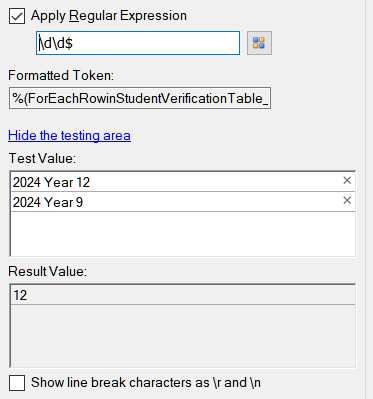

Hi all,
New to expressions,  not sure why this isn't fully working.
I'm trying to extract the last 2 or 1 numbers from a string. It seems to work if there are 2 numbers but not 1?
Any help appreciated.
Thanks
replied on August 3, 2023 • Show version history
Your expression is implicit that it is looking for 2 digits at the end.
You can make the expression more flexible by using \d{1,2}$
- this means the it is looking for 1 or 2 digits at the end of the string
or \d?\d$
- the ? means Optional, so it says it's looking for 1 digit at the end with an option for a digit in front of it.
5 0
Thank you Steve,
Perfect, thanks for the explanation, that is very helpful.
Much appreciated
