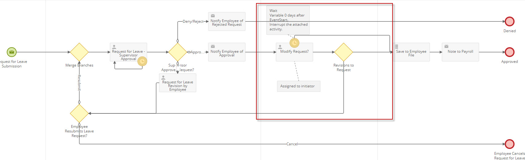

We have a leave request form that may or may not require amendments after approval, before sending to the repository.
Synopsis of current process:
User submits vacation request. Manager approves. Saves to repository.
Use case where above doesn't work:
Weeks go by, employee changes plans and will NOT take vacation at that time. Repository reflects inaccurate information.
I'm not quite sure if/how to program this, but it seems to me like it would be helpful to have it kind of as follows (is this possible?):
   Create an optional user task assigned to the initiator where they can edit and resubmit the request to their manager, or cancel their request.
   Wait until variable StartDate equals today. If above task isn't acted upon by the date they take their vacation, proceed to save to repository task. I've attached the process diagram and I've added an exclusive gateway where I think something like this would go (see red box).
Is this a possibility? How would you program it?

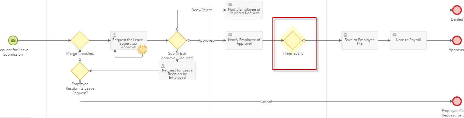

I've been playing with this a little bit and have added a user task with a timer attached. I haven't dealt with timers all that much. Does it look like I programmed it right? See attached.
replied on August 2, 2023
The configuration looks right assuming the timer values are set the way you want. The solid outline on the timer means it is set to interrupt the task, so it should sit in their inbox until the timer runs out.
replied on August 3, 2023
That sounds about right. I'll run through some testing. Thank you!
