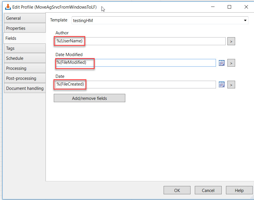

I have been reading posts from the help forums, and it seems like there is a way to do this using workflow tokens and import agent. I have tried using the tokens for author/date created/date modified in a test import agent profile (see below), but they didn't seem to change the file metadata at all - upon importing into LF, the edited/updated dates defaulted to the date of import.

Nothing is going to override the values in the Created and Created By column. Those reflect the date when the document was created in Laserfiche and the user who did it.
You can keep the "original" values from when the files were created on disk in template fields. But you can't use them to update the system columns.

hmm okay, thank you. I figured out how to use tokens in import agent to assign the created/modified dates to template fields like Miruna suggested (it's a shame about not being able to have the Windows values just transfer when files are imported). I'm trying to get a process to handle the Author/Owner field now. Thanks for your assistance!
