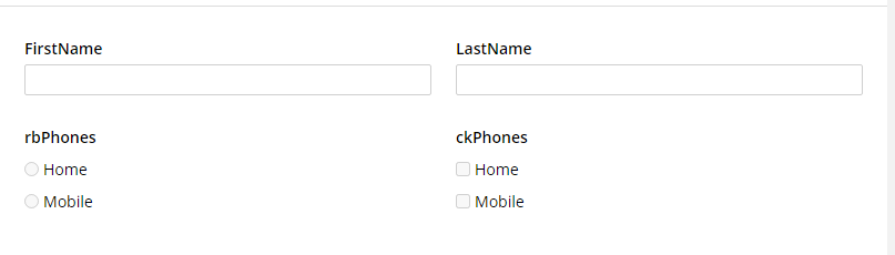

I setup a simple form (new format) that has:
  • FirstName (Single field)
  • LastName (Single field)
  • rbPhones (radio button - 2 options: Home, Mobile)
  • ckPhones (check box - 2 options: Home, Mobile)
I set the BP to allow "invoke business process" (so we can pass variables from WF) and selected the 4 input variables.

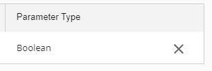

** The checkbok phones is listed as "Boolean" as Parameter Type here**
I re-worked the workflow to start the test BP and matched the fields.
When I run the workflow:
  • The variable ckPhones (checkbox) never gets the values that are sent from the workflow (selecting 1 option or both)
  • The workflow instance never completes (shows running even though the BP has submitted the form)
What are we missing with passing the variable to checkboxes from a workflow to a business process?

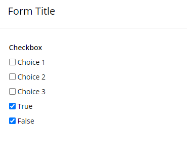

It does work, it just has the wrong tag. It has a Boolean tag which means it only accepts 2 possible values; True or False. Therefor if True or False happen to be options in your checkbox menu it works, if any other strings are used you can't pass that information.
The tag just needs to be changed from Boolean to String. But there is no option to click and change it here on the input params screen.
Here is a task assigned by workflow successfully, I just can't pass something like "Choice 1" to a Boolean.
