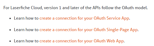

I can not seem to find the documentation on how to authenticate with a service principal key. We are connecting from On-Prem Workflow, which is a Windows low-code service (the HTTP Post activity).
There are only 3 options available to connect to Cloud
It seems we only fall into the first category.
In this article it only provides either using the access key which expires or HMAC

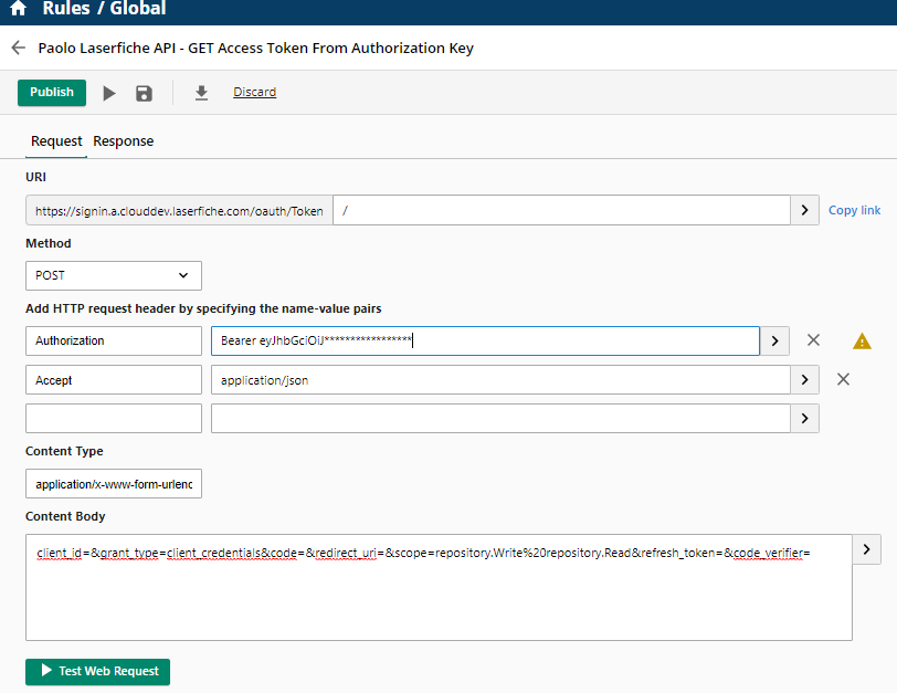

I have an example of using WF Cloud to call Laserfiche API Cloud. You should be able to adapt it to WF self-hosted:
To get API "Access Token" using the "long-lasting authorization key":

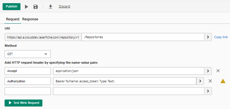

And then use the Access Token to call APIs (e.g. get a list of repositories):

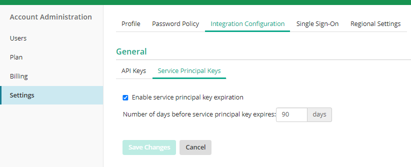

Note: You can configure the Service Principal key (and related API long-lasting authorization key) to never expire:
replied on July 20, 2023 • Show version history

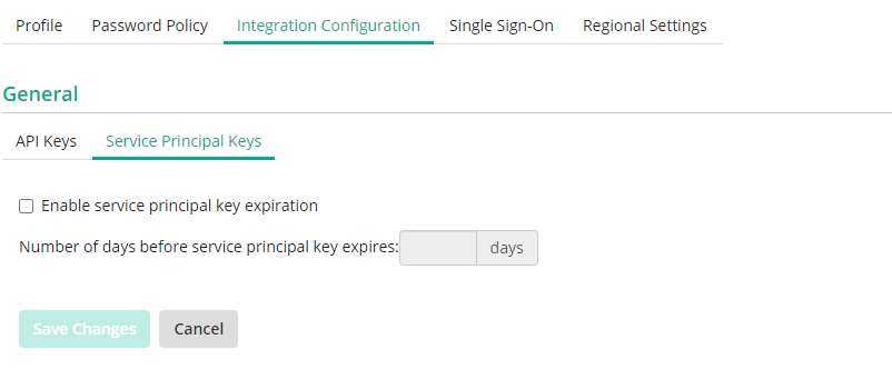

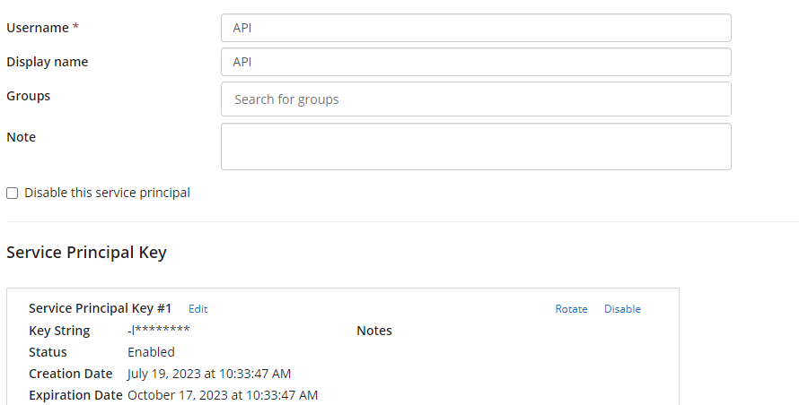

I have tried unchecking that box under Account > Settings > Integration Configuration and saving.
However if I view my service principal user an expiration date still shows.

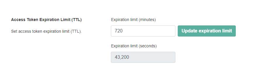

Update: After unchecking the box, you must rotate the key and this part gets updated to show no expiration date. But the configuration for the access token in the developer console shown below is still showing that it will expire. Although we don't even know what an access token is, the password is the access key not the token.
And ultimately what your are using in the Bearer header to login is the Access Key, although this key depends on these other 2 configurations to access the repository.
If I log into my developer console and review my Access Key configuration it still shows an expiration time on the Access Key as well
replied on July 24, 2023
You need to rotate the Service Principal Key for the Expiration Date change to take effect.
Yes, the "Access Token" obtained from the long lasting OAuth application "authorizationKey" will still expire after 720 minutes max (or less based on configuration) and a new one needs to be obtained using the "authorizationKey".
FYI: Laserfiche API Client libraries handle "Access Token" refresh automatically (no explicit user code needed).
Oh I understand this final expiration, this is how much time you have to call your method(s) after requesting the 2nd Bearer token. That is perfectly ok, as long as the primary password does not expire suddenly and without warning.
