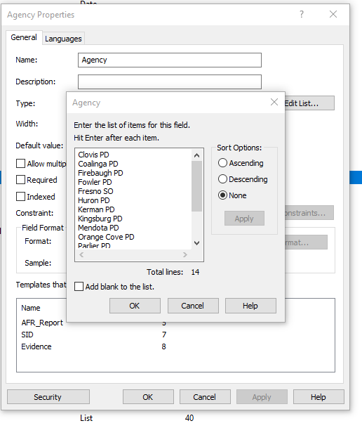

We have several list that need to be cleaned up. Items in our dropped down are no longer releveant. If i delete the field how can we later search. My consern is that we will not remeber what the field was called or that it existed. take for example Clovis PD, no longer needed. When i remove it, its no longer part of the search .

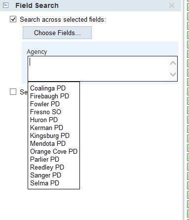

This exact use case is why the input field in search allows the user to enter text that is no longer part of the list. So it's going to be possible to run a search with the old value. But you bring up a good point - if the value is not part of the dropdown, the user needs to enter the value without assistance, and they might need you to explain why it's not there. What's really going to help is the consistency of your values, visible in the screenshot. I would think that would be enough guidance for a user to understand how to correctly enter the name of the agency so that it matches the records they are looking for.
