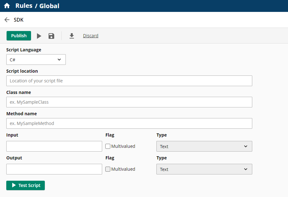

Hi,
I need a clarification regarding how to write a C# code in Laserfiche Cloud workflow Because its asking for location as given below.
where that location will point. And for adding a dynamic fields for a template it points to a lookup table where the user can only import a data from a excel or csv file not from the database. Is there any way to point from the database because in our client side we have dynamic data always so we need to map it with the table from a database.
Thanks,
Vharsha

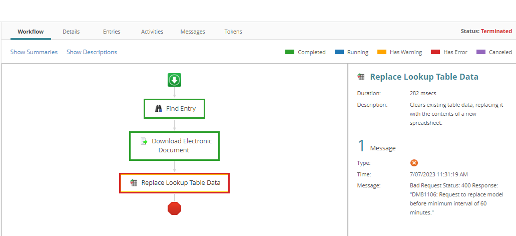

replied on July 6, 2023
Hi,
I have tried updating the lookup table through workflow but it has issue when we update it before 60 minutes I have also attached the screenshot. Is there any way to reduce the time for updating the lookup table. In our process we need immediate update on lookup table.

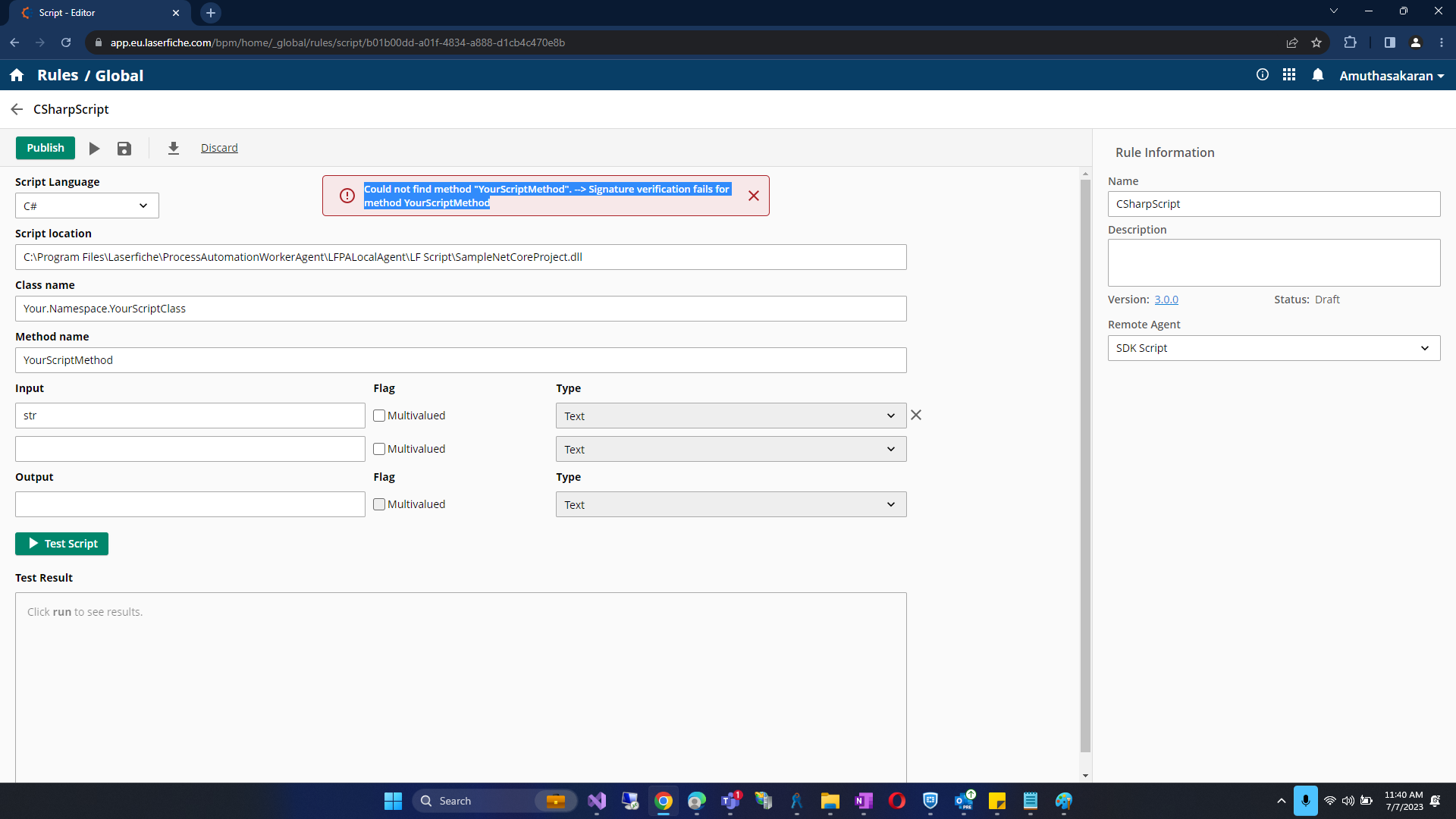

And we have an another issue in C# script while running the script. Please refer the below image

replied on July 7, 2023
Replacing the entire contents of the table can only be done once an hour. Updates to individual rows are not rate limited.
Can you give us more details on why you need to replace the entire table more frequently?
replied on July 9, 2023 • Show version history
Hi Miruna,
In our on-premises solution we have a LF form where the user can create or delete a client which is stored in a table were that table is mapping as dynamic fields for all the template.
so what happens is when a user creates or deletes the client it reflects for their templates but in LF Cloud we have lookup tables which can only be updated once in an hour but we need immediate update when users changes in the form, so when the user updates I would like to initiate the above workflow.
Please guide me that how to update the individual row in look up table through workflow.
replied on July 10, 2023
You can use a query rule to update or insert a specific row in a lookup table.
Re. "signature verification fail". Verify C# script function argument and return types to be:
public static Task<IDictionary<string, object>> YourScriptAsync(IDictionary<string, object> inputs)
P.S. the method does not need to be static

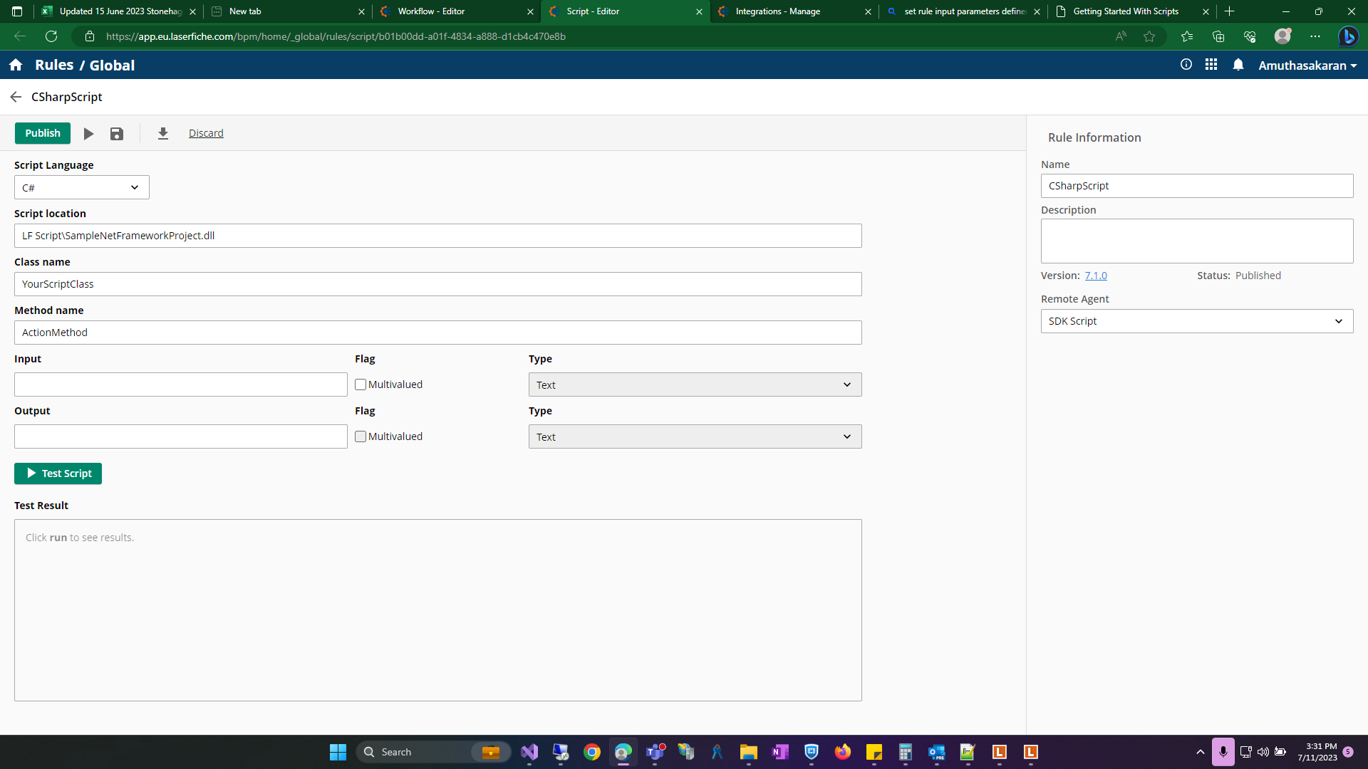

How to set a Input and Output parameter in C# script rule?
and how to add the reference DLLs, Is that in visual studio NuGet packages and has some other configuration?
SDK Script.png (161.66 KB)

replied on July 11, 2023 • Show version history
Hi Paolo Argentieri,
Thanks for sharing this sample code but we need to know how to pass the input and output parameter for this script.
1) In our code when a input is passed the output should return a value which is what we are not getting when executing the script in script rule.
2) Please let me know how to pass the input and output through workflow.

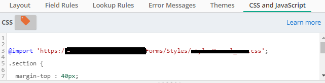

And had an other question in LF Cloud forms After importing the form from the on premises we have a convert form option which convert the on premises form to Cloud but when we are doing so the Java script and CSS of the on premises form is not converting. and in on premises we have an option to import the CSS file from the local C drive in the following location
C:\Program Files\Laserfiche\Laserfiche Forms\Forms\Styles
but how to integrate the CSS file in Laserfiche cloud. I have attached the image for your reference
replied on July 13, 2023

replied on July 17, 2023
Hi Vharsha,
To use script outputs you need to configure them in the Output section of the rule definition.
I have updated the readme for the sample C# script rules with step-by-step instruction on how to build-configure-test: https://github.com/Laserfiche/lf-sample-csharp-script-rules
For the C# script question. Remote agent worker is working under net-framework environment.
Can you try "SampleNetFrameworkProject.csproj" instead of "SampleNetCoreProject.csproj"

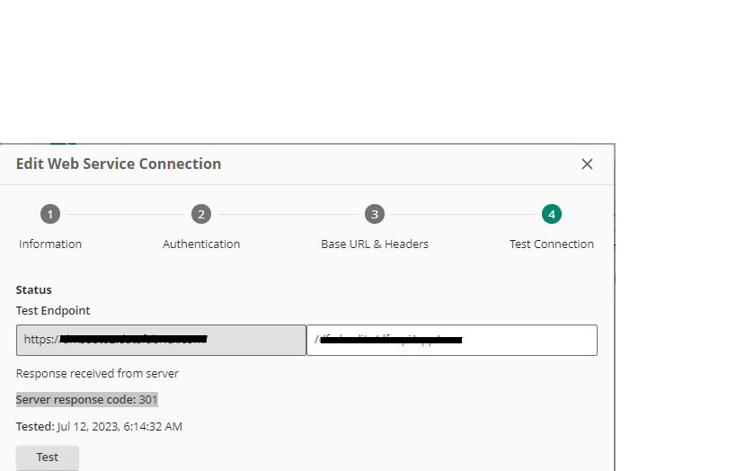

replied on July 12, 2023

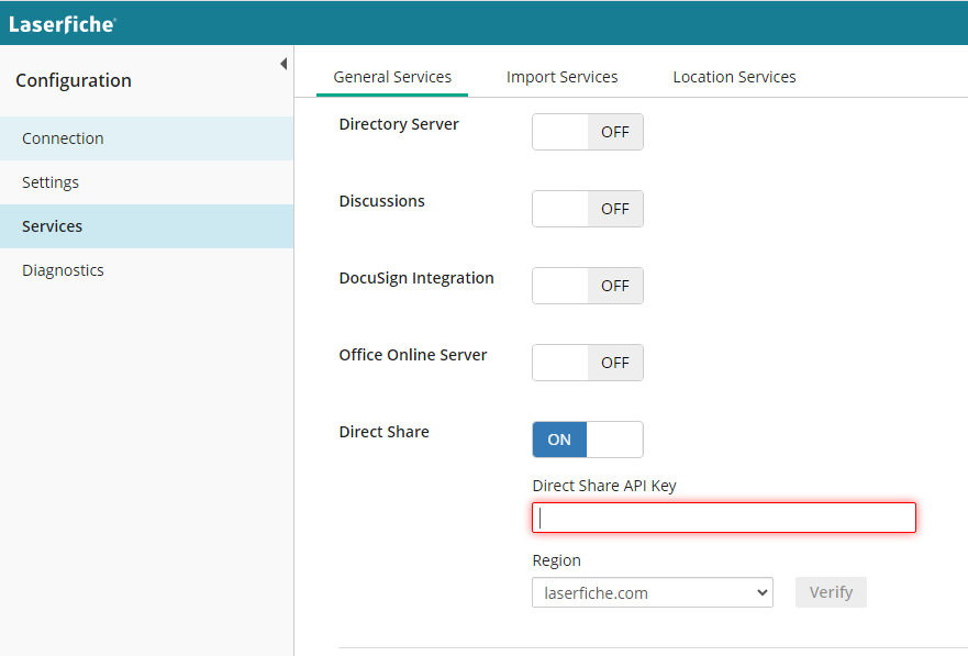

I need an other clarification in configuring the Web Services we are getting 301 error while testing for any URLs it matters. I have also attached the screenshot for your reference. Please guide me how to resolve it and the configuration guide.
And while configuring the direct share in On premises where we will get the API Key? and attached the screenshot.
WEB Service.png (17.34 KB)
Direct Share.PNG (30.25 KB)
