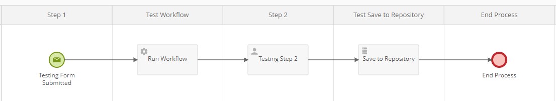

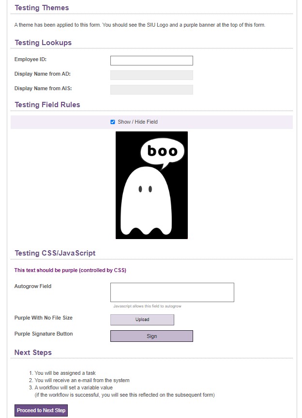

In the end, I didn't build a checklist, but we did throw together a "Testing Process" we could run post-upgrade.
Form 1 in the process includes: a theme, lookups, field rules, CSS, and JS.
We then run a Workflow that returns a value to Form 2, route a user task back to the initiator with an e-mail notification, and save the form to the repository.
We run this process in both Forms and Forms Portal.
It's an extremely basic process, but did catch an issue with our connection to Workflow that we were able to correct right away.
Aside from that, we did see several "hung" processes that needed to be nudged (mainly just restarting workflows).
Good luck!
