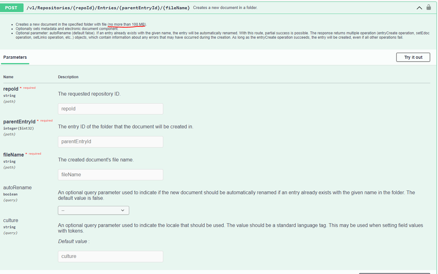

replied on June 26, 2023
The maximum file size allowed for our current V1 import API is 100Mb. It's documented in the API Swagger page.
We will have an import API to handle uploading large file in V2.
