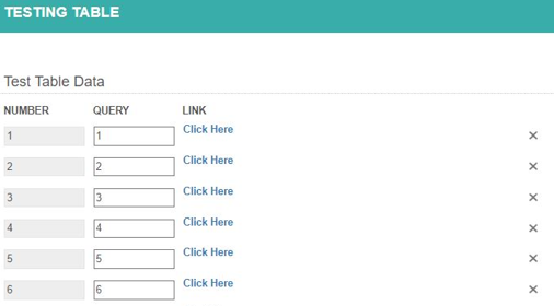

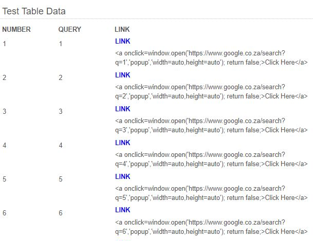

I have been trying to clear the link column and preventing it from showing the actual link(it looks untidy) in text form. i have created a hyperlink and it correctly displays this link as intended, however, when i go to my "Monitor" screen and view the tasks(prior to the main completed task "User Task(1)"), it displays the untidy link.
I need help clearing this untidy link so that it does not display anything in the LINK column and keeps the final form as it is now

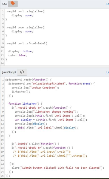

I have used the following CSS and JS code to get to my current result
When i clear the link value then the hyperlink on the final submission disappears as well. i need the untidy url to disappear on submission but keep my hyperlink on the final form

The readonly form has different structure compared with the normal one. So your js may need some adjustment according to the difference.
For example, the query to select the hidden url tag can be changed to:
var display = $(this).find('.url input').val();
if (display === '' || display === undefined){
      display = $(this).find('.url div.ro')[0].innerHTML;
Another thing to notice is that the linksshow function is executed when onloadlookupfinished event, such event won't trigger in a completed form.
