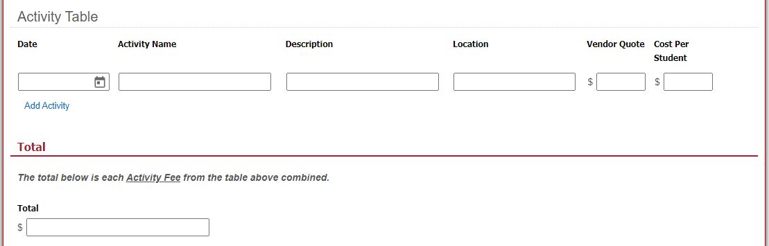

Hello,
I'm trying to come up with a formula to total up a column within a table. The table will have a varying number of rows so depending on how many Activity Fees are added. Has anyone done something like this? I need to add all of the Vendor Quote fields together at the bottom in the form in the Total field. Thanks.
replied on June 20, 2023
You should be able to use the SUM function on the total field after the table.
It'll look something like this:
=SUM(table_variable.vendor_quote_variable)
Thanks. I tried this earlier but I must have had a variable wrong. Its working.
If you are expecting multiple rows you will need to add the ROW() piece.  I have a similar setup and I use this.  I just inserted your table.field in the example
=SUM(table_variable.vendor_quote_variable,ROW()="0")
