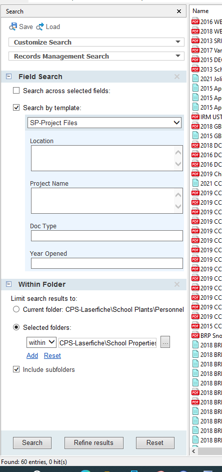

I am trying to find all the documents in this folder that do not have the "School Properties" template applied.

Actually three wrong templates as well as no template at all.
replied on June 12, 2023
I can actually do a template search and find the information.  Basically there is one wrong template being used in that folder.
You can have the system create the search syntax using those other searches like that.
Do the search the way you just did, but with the template the documents are supposed to have, and include the "Search Syntax" option but the "Include search syntax in query" checkbox turned off.  You'll probably see a ton of results since that is your expected criteria.
When you run the search, it'll create the search syntax for you.  After that, you can close out the "Field Search" and "Within Folder" search, so that you just have the "Search Syntax" option.  Then you can mark the "Include search syntax in query" checkbox so that you can edit the syntax.
It will have generated the syntax searching for the desired template, but you should be able to just add the - symbol to change that part to be "not true" instead of "true".
Hopefully that all makes sense.
