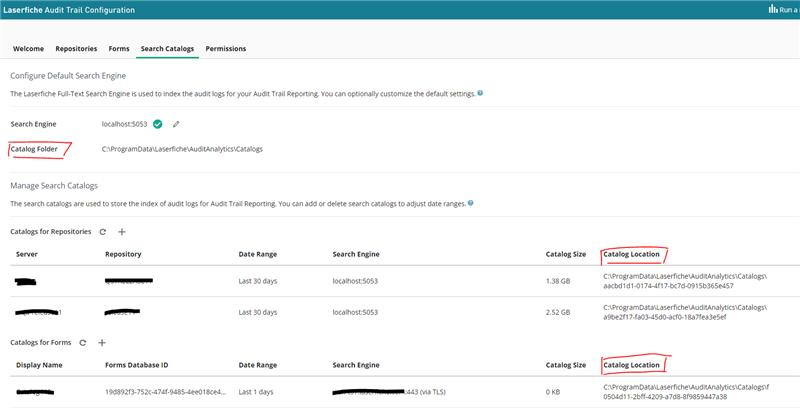

This error indicates invalid character in some audit catalog path. Could you check if there is any invalid char (*?"<>|) in the following places on Audit Trail Configuration Site?
Also, if the error does not occur in the recent day and all catalogs on this "Search Catalog" tab are running correctly ("Status" is green and "Catalog Size" is not zero or empty), then the error might a false alarm due to some intermediate state of Audit Trail.
