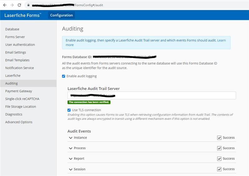

We've verified there's clear connectivity from the Forms server to the server hosting the Audit Trail Event Hub service on TCP 10256, the Forms config page for Auditing shows the green "The connection has been verified", and indeed the Forms catalog has been created and has events populated in it (and actively populating still).  But it appears we are having periods where Forms logs this event over 100 times in an hour.... and then, just as suddenly, stops logging it.

How do we check the connection from Forms to the Audit Trail Hub Service?  What ports need to be open between the servers and how do we check that it is using the correct server name?
replied on October 10, 2023

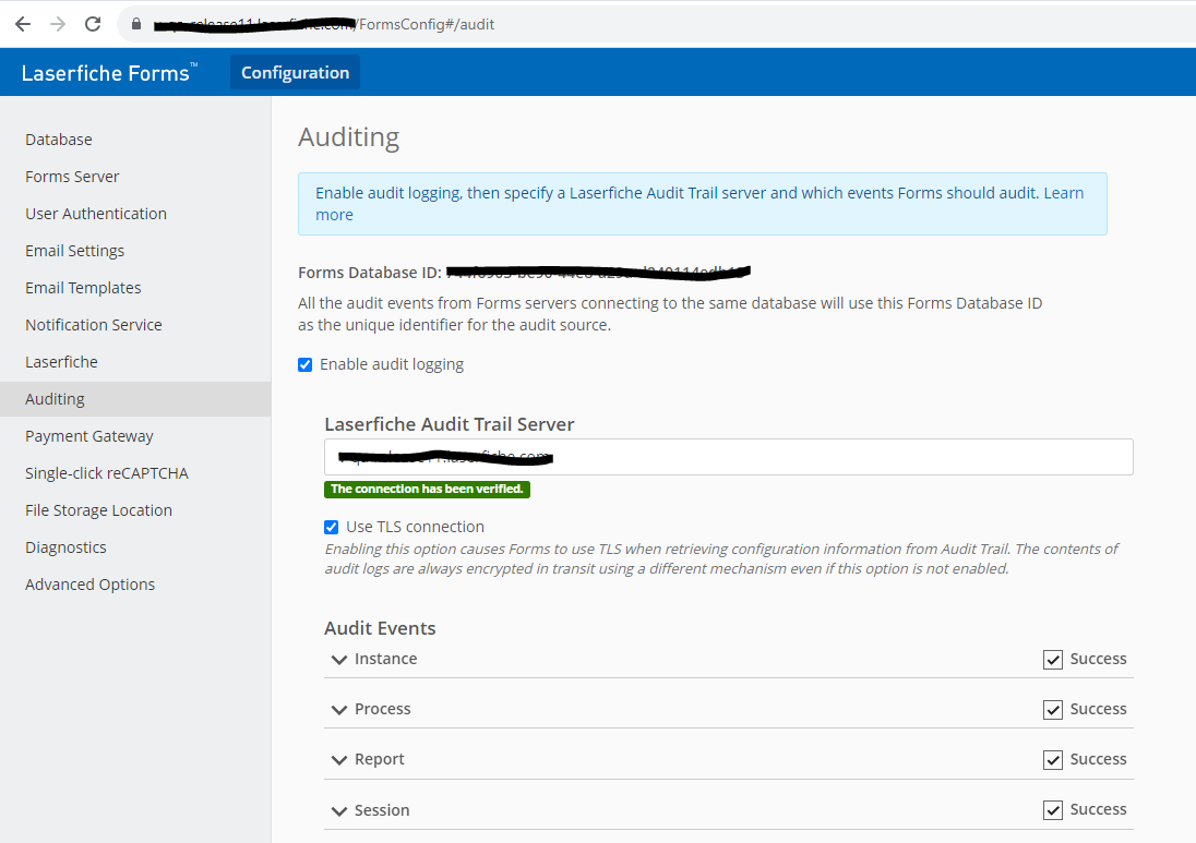

To configure Forms Auditing, the following endpoints on Audit Trail server must be accessible to Forms service:
  1. TCP port 10256
  2. Audit Trail Configuration Site https://{server FQDN}/AuditTrailConfig
There is no specific port needed on Forms server.
You can check connection between Forms and Audit Trail on Forms Configuration Site, tab "Auditing". The green mark "The connection has been verified" indicates successful connection.

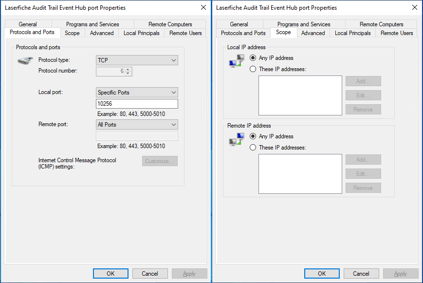

Is the Port 10256 correct?  I cannot het that port with telnet or Test-NetConnection.
The port is allowed through the firewall on the AT server.
