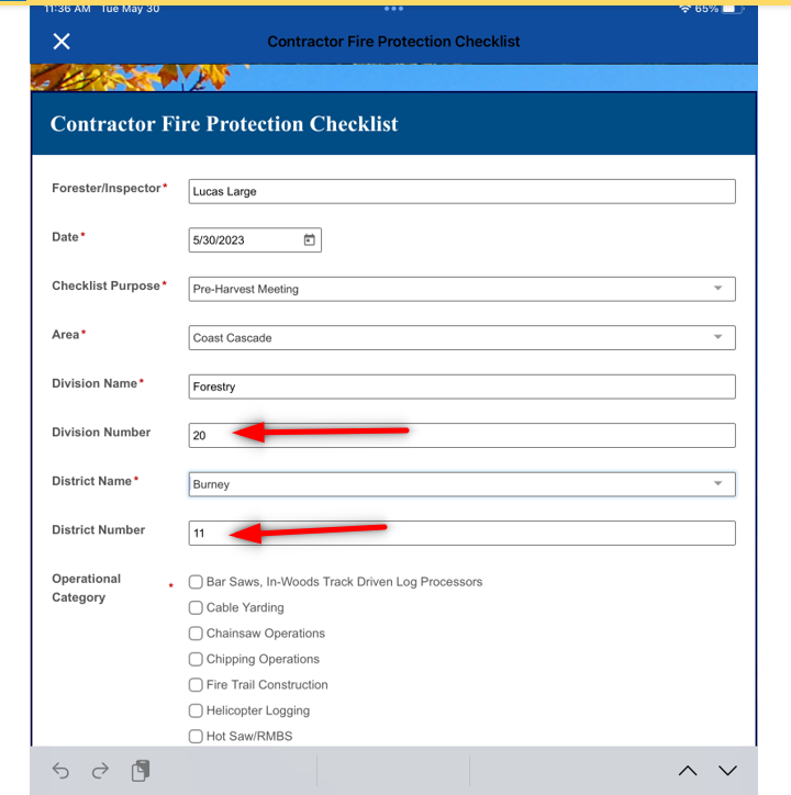

Here is the form when filled out normally and not with offline data.
You can see that the division number is 20 and the district number is 11. Those are values from a lookup table.

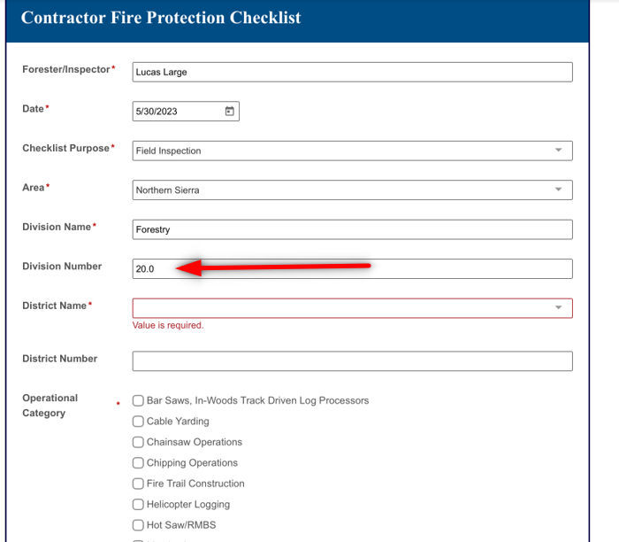

This is the form filled out in offline mode.
Here the 20 is filled in with a decimal place value which then breaks my rule for getting values into the District name. Nothing comes up in the District name when it's 20.0.

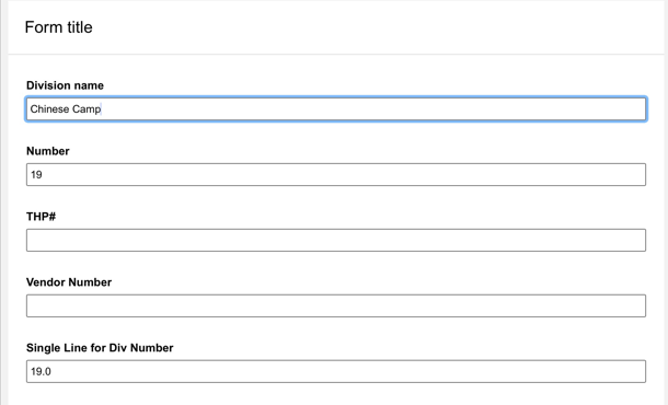

Has anyone seen this before? The Division number field is a single-line field and not a number. the data from the View is a decimal 2,0. Is syncing the data to the mobile device changing the format?

I just want to add, I'm getting this again even after changing the database column that holds those values to a CHAR 2. I thought that if I changed the values to Char(2) that storing in the local DB in the app wouldn't change them. It still gives my number a decimal and a 0 when placed into a single-line field.
Is this normal?
