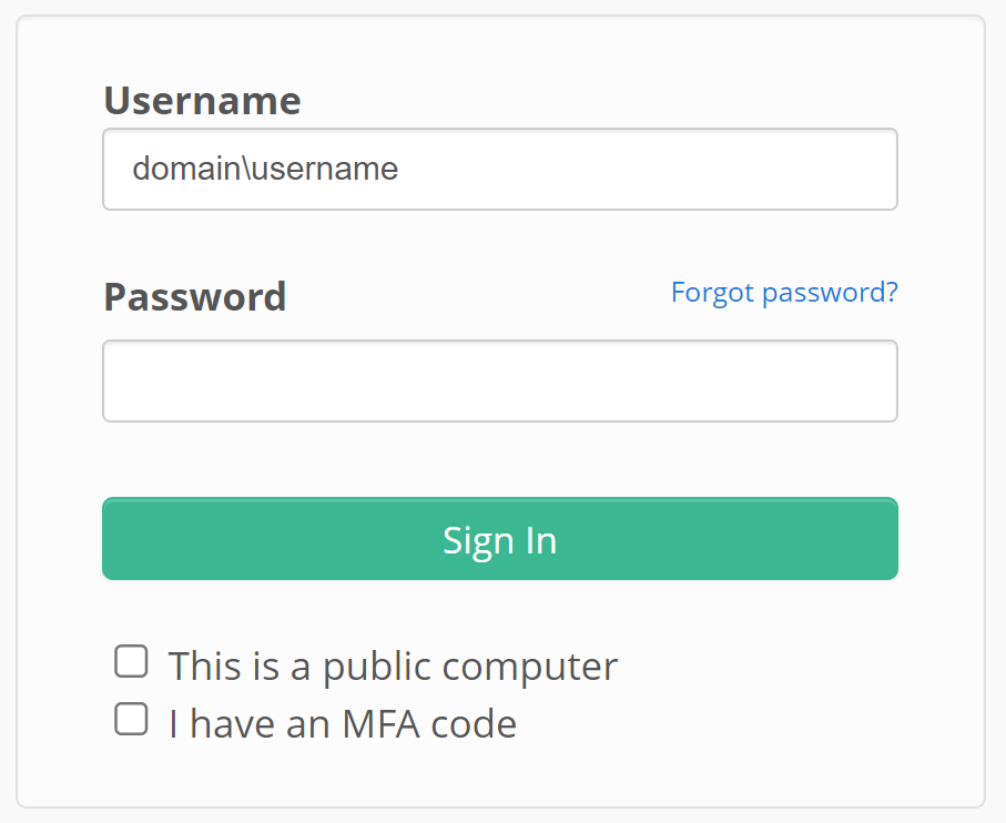

replied on May 23, 2023
Something worth noting is that if you are using Windows Authentication, when you log in using a username/password, you need to include the domain.
For example,
domain\username
yes, we are using our domain on our login. We have to use it when logging onto forms when our network and the login works. Only when accessing the link which takes us elsewhere to login.
