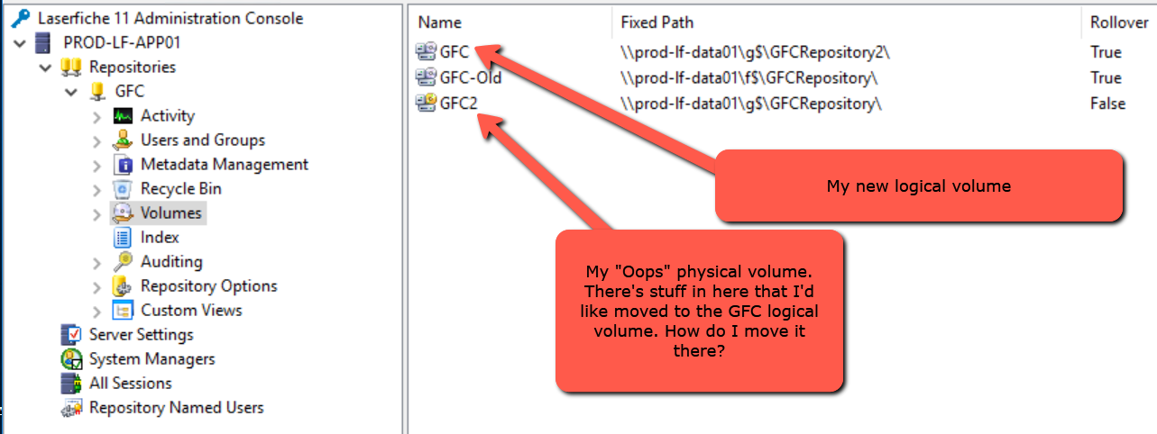

The network drive that our volumes exist in became full, so we created a new drive to save to.

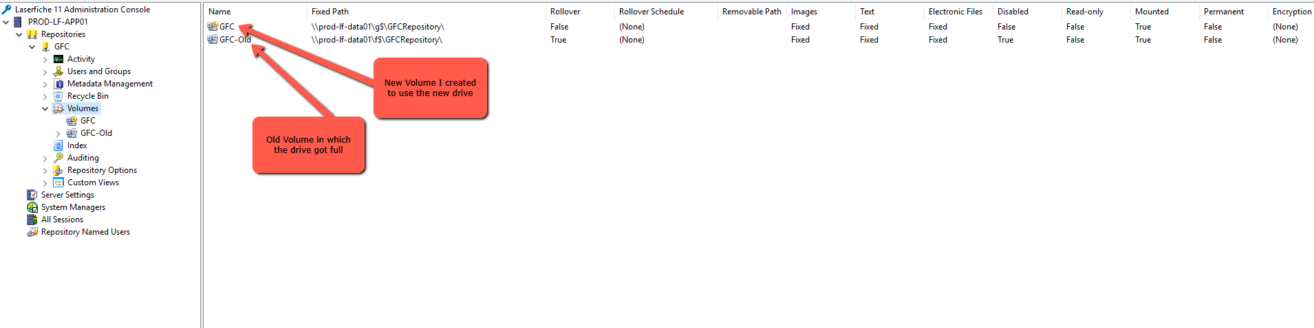

Then I went into the Admin Console and attempted to create a new volume so it would switch from the old drive to the new one. I tried to set up the new volume the same way as the existing volume, but I don't think I did it correctly.
It looks like the old volume is a group of volumes and my new volume is just a singular volume. I don't know how to create a group of volumes in here. It does have a maximum size limit on it, and it does not have a rollover schedule.

Thanks for the response, Jason! I actually noticed that after submitting this, that it should have been a logical volume.
So now, I have my new logical volume set up, but I have this physical volume that I was using for a few hours. There's a bunch of stuff in it now. Would you know how I move the stuff out of that physical volume into the new logical volume I just created?

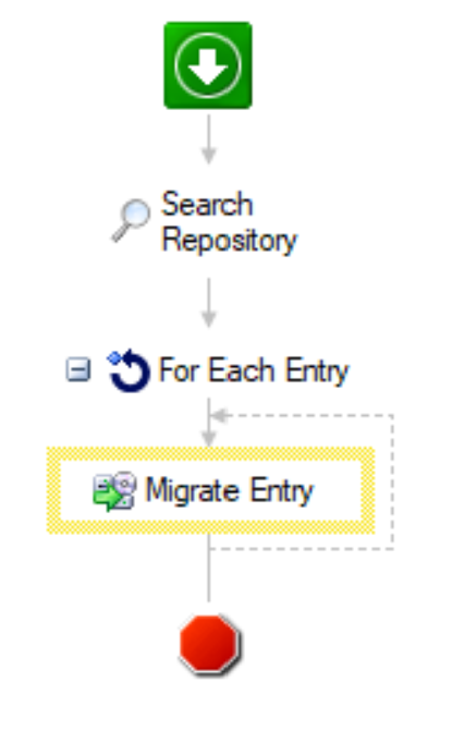

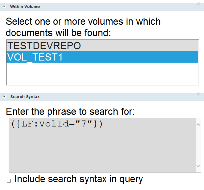

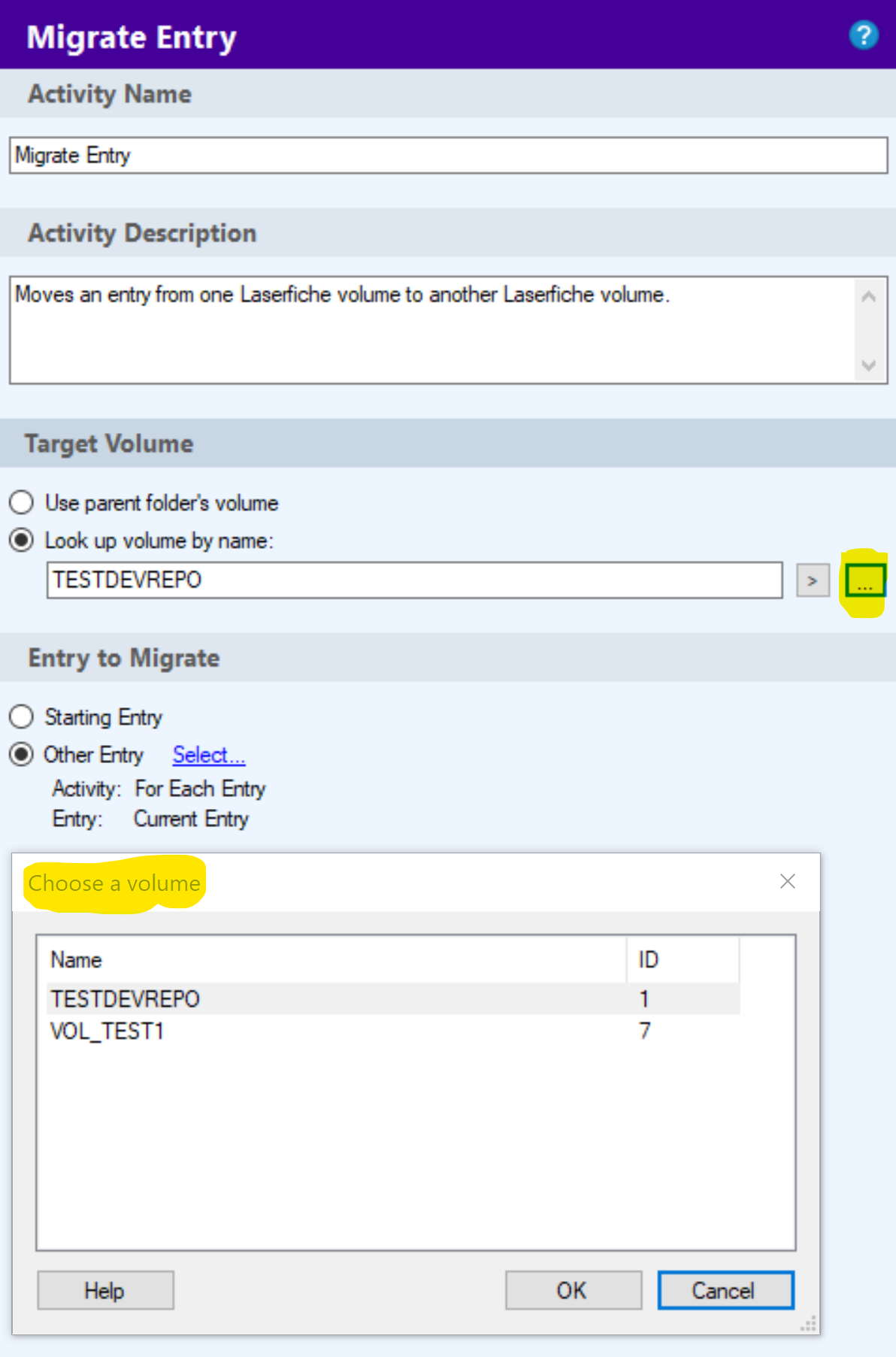

Either way, the best bet for moving things is probably workflow. You can use advanced search syntax in a Search Activity. For example ({LF:VolId="7"})
Then, use a for each entry loop with the Migrate Entries task to move things from the desired volume.
You can use the LF Client to do a Within Volume search with the Search Syntax box visible as a quick way to get the query. Basically, you're just running a search for all entries stored in your "oops" volume.
Then, plug that search syntax into the Search Repository activity in workflow, and loop through the results.
You'd then set the Migrate Entry activity to move each entry. The ellipsis menu will let you select the destination volume; it also shows the volume id values if you want to get them that way rather than using the LF Client get the query.

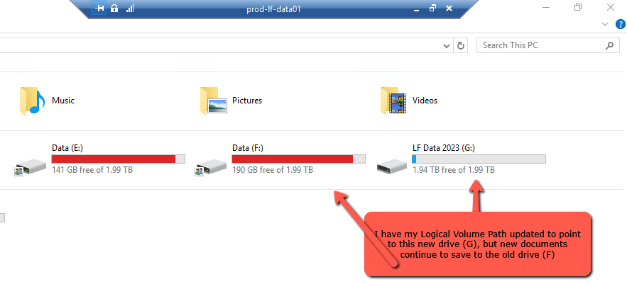

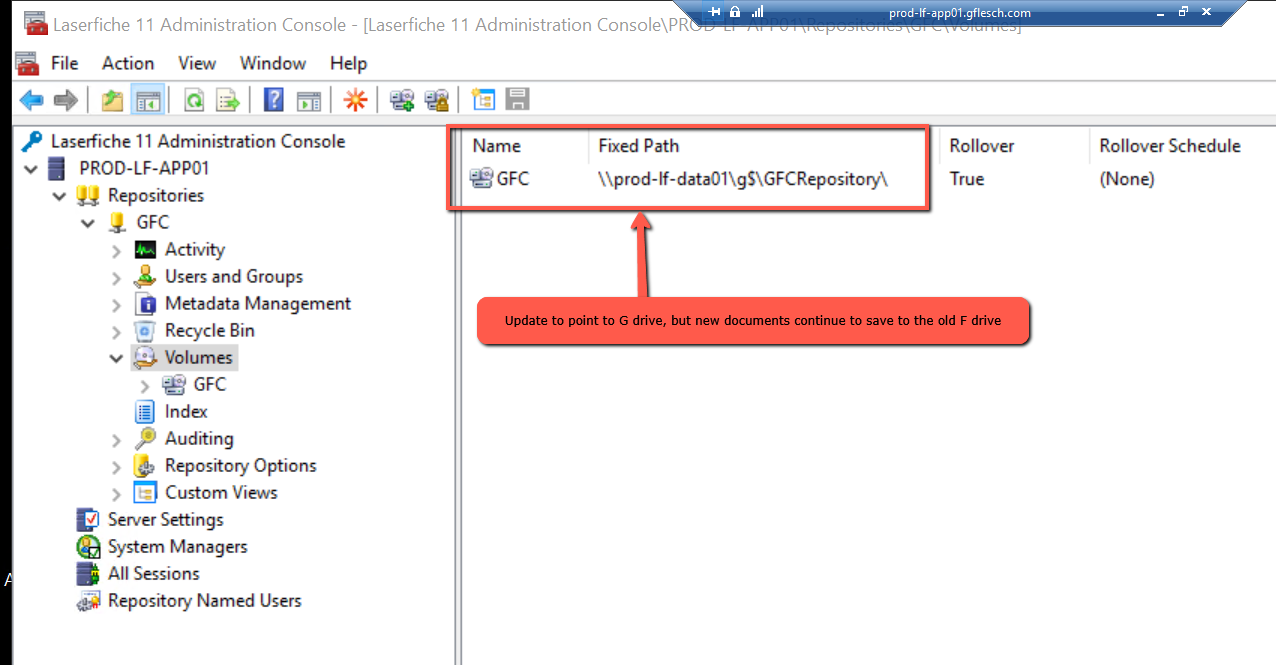

Hi Jason, this is all very helpful. I super appreciate this education. I have the OOPS volume cleared out and deleted, and all I have now is my original volume, but updated to the new drive path.
I will say, I was expecting new documents to start saving to the new drive, but it looks like they're continuing to save to the old drive. Is that maybe just because LF hasn't deemed the old drive full enough yet, you think? (see attached screenshots)
replied on May 12, 2023
Yes that is correct. Logical volumes "roll over" when they reach the set size limit but they'll continue using the active folder until that point.
Most likely the "current" volume folder is still within the configured limit, but once it rolls over the new folder should use the new path.
