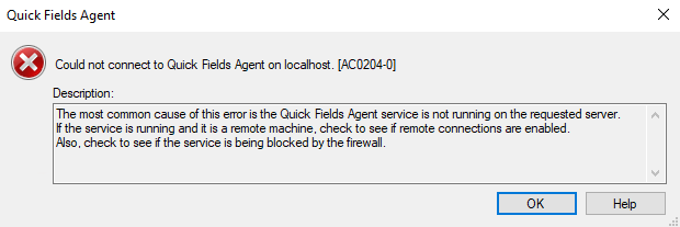

Could not connect to Quick Fields Agent on localhost. [AC0204-0] Error
asked on May 3, 2023 • Show version history
After I connect the QF Agent Admin Console and connect to the local machine, I get the following error:
The QF Agent service is running and all Firewalls are turned off.
What would else should I be looking at to get around this error?
Running Quick Fields 11 Update 3.
replied on May 3, 2023 • Show version history
It looks like it was permissions related. I received another error that mentioned access denied. I switched the account that was running the QF Agent to 'Local System' and that has resolved both errors.

Well this is interesting. If instead of telling it to connect to 'Connect to the Quick Fields Agen service on: This computer' and instead enter the server name manually it works as expected. Not sure if that's a bug but seems weird.
