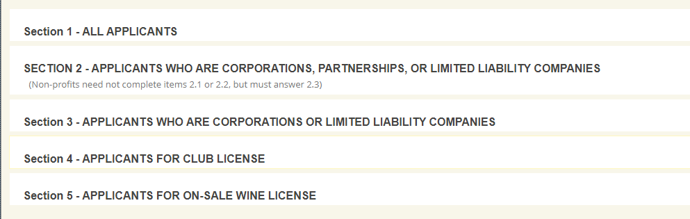

I am wondering if anyone else has had issues with the field lookup rules in Forms Version 11.

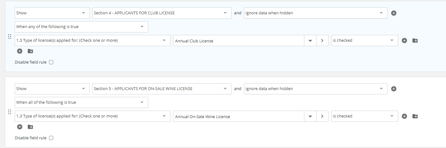

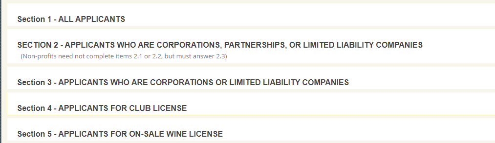

I have "sections" created that I want to show or hide based on a check box. However the Sections "always" show until the "a" box is checked. I think in the old version it would always hide until the "show" condition was met. I have tried lots rules and can't get the section to hide at the start of the form unless they check the box.
Also another item I noticed is when the user completes the form then "all" sections print and not just the ones they had to fill out.  So if they don't need section 4 I don't want section 4 to print for them or be stored into Laserfiche.
replied on April 12, 2023
Try changing the condition to hide when the box is not checked instead of show when checked.
I had tried that also with no luck. I made a copy of the process to do more testing and it suddenly worked as needed. I went back to the "published" one and that now works. It was so odd. Now I am working on the phone/SS# masking part :(
