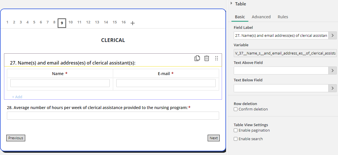

I have a table element with two fields, name and email, as shown below.
and, of course, it has the '+ Add' link to add rows to the table. What I am trying to do is the capitalize the Name field for each row. The below line will capitalize the initial row, but no others.

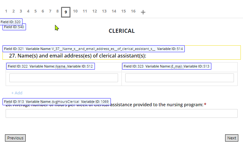

And below is the field numbering:
Question is: How do you address each row of the first column in a table, so that, I can run the capitalize function? Also, how do you know the number of rows in the table so that I could maybe use a foreach method?

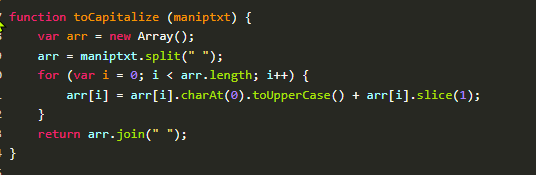

function toCapitalize (maniptxt) {
  var arr = new Array();
  arr = maniptxt.split(" ");
  for (var i = 0; i < arr.length; i++) {
    arr[i] = arr[i].charAt(0).toUpperCase() + arr[i].slice(1);
  return arr.join(" ");
In that example, I'm adding the functionality to field IDs 2, 3, 4, and 5 (the first several lines of code) by calling the function 4 times and passing in each ID.  You can see in this screenshot (I wrote everything entirely in lower case) that it is working for fields 2 and 3 in the table, and for fields 4 and 5 outside the table:
