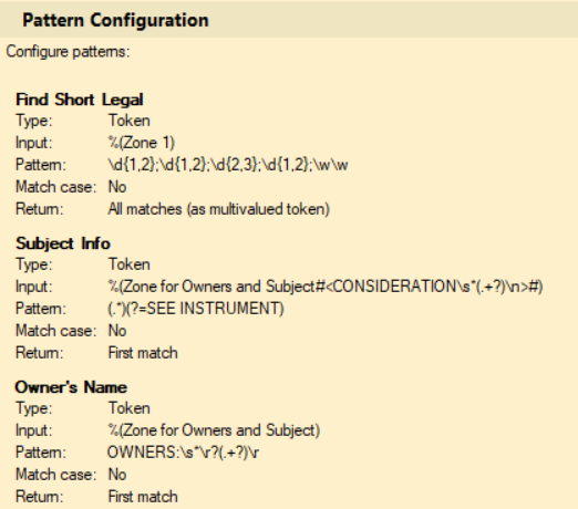

The fact that it is matching in your testing, but not in the live processing, makes me wonder if there is a difference in line breaks between your testing and the live form.
In Windows, you're going to see line breaks as \r\n but within data from a database or other process, you may only see \r or \n, so I think it might be better to tell it to check for \r or \n or both.  If we say [\r\n]* it will match 0 to infinite occurrences of \r or \n, so it could also match \r\n or \n\r or \r\r\r\r\n, etc.
I just tested this:
OWNERS:\s*[\r\n]*(.*)[\r\n]*
in both Workflow and at regex101.com and it seemed to work for me.
Note that the match group you had in your screenshot   (.+?)   is probably just going to grab the first letter in the name, whereas using   (.*)   will end up grabbing everything up until it encounters the following values (which is a line break).

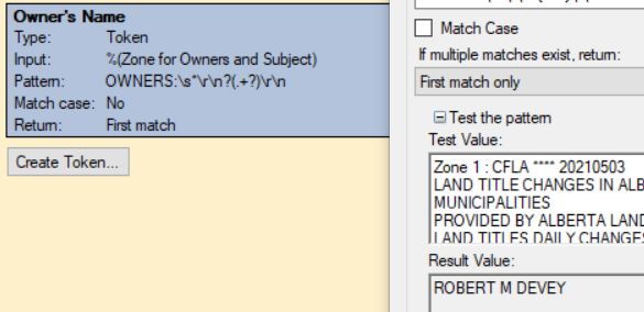

Matthew, I'm looking more closely at your notes now and can tell you that I did try \n at first and while looking to get better results, I did also try the \r\n because the "Show line break characters as \r and \n" was showing that the Result Value was the owners name plus \r.  So I left the \r\n in my formula.  Just now tried OWNERS:\s*\r?(.+?)\r but it is still the same result... no owners in the fields, but in testing it looks great.
I was using the (.+?) because it was successfully grabbing only the person's name and not the mailing address that is on the lines below.  Just now I tried changing the (.+?) to the (.*) and not changing anything else and the result was a collection of the name and everything below that line.
I did remove the "Match Case" checkmark.
Regarding whitespaces... my scanned pages do have an issue with spreading out letters, however, I was collecting the Output collection and using it for the "Test the pattern" steps hoping that it was a true test using only what text was actually captured by the Zone OCR.

In answer to your question about what the OCR is pulling... I believe it is pulling the OWNERS: okay as I was copying the Quick Fields output results to test with and it looked okay. I did want to try a RegEx that would account for if blank spaces were found, just in case that was it, so thank you for that sample! I just tried your RegEx and I did get a different result on one of the two entries that QF was acting on. The first entry, it still did not add the owner's name into the field even though I can see in the output results that the Pattern Matching activity DID successfully pull the correct name. On the second entry in the test run, it DID find the property owner's name AND DID successfully place that result in the Owners name field, but also picked up the next line which included the guy's box number:
replied on April 6, 2023
That's weird - it's like it ignored the line break after the name.  But .* shouldn't include line breaks.  I wonder if QF handles that part of RegEx differently...
Where you said that (.+?) was working in your testing instead of (.*) - why don't you try using (.+?) again in the example where it grabbed the box number after the name?
Okay, I can report that I now have all the fields filling at least some of the time.  For some reason, the owner's names do not always fill, but if it is filling sometimes, then at least I know the configuration is right.  Something else is stopping it some times.
In the last test, there were about ten documents separated into individual entries and handled.  One did not fill in the owner name because there were 3's accidentally filling spaces all over the document.  Next one I couldn't see a reason why.  Next one I couldn't see why and the next one was the exact same as the previous one (exact same name and look on the page!) and yet it DID fill in!

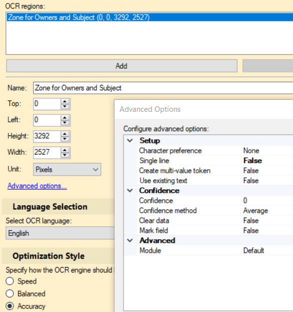

Double checking the Zone OCR.  Of note is:  This zone is used to collect two things (1) owner's name and (2) subject info for a Subject field in the template.  The Subject field is getting what is needed as per the Pattern Matching config for that one, yet the owner name isn't getting filled.
