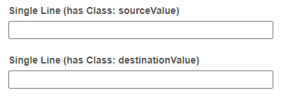

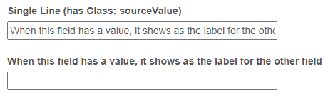

I've done this kind of thing with Javascript before.
This works on Classic Designer Version 11.0.2212.30907:
  //Save the original label from the destinationValue field
  //so after it is changed, we can revert to it later if needed.
  var destinationValueOriginal = $('.destinationValue').find('.cf-label').find('span').find('span').first().text();
  //When the form loads, take the value from sourceValue field
  //and load it as the label on the destinationValue field.
  //This only happens if the sourceValue is not blank (was
  //populated from a prior task).
  var newLabel = $('.sourceValue input').val();
  if(newLabel != '') {
    $('.destinationValue').find('.cf-label').find('span').find('span').first().text(newLabel);
  //When the value of the sourceValue field is changed, update
  //the destinationValue field to use the sourceValue as the label.
  $('.sourceValue input').change(function() {
    var newLabel = $(this).val();
    else {
      $('.destinationValue').find('.cf-label').find('span').find('span').first().text(destinationValueOriginal);
EDIT TO ADD: Note that Javascript above works on the active version of the form, but not the read-only version (or the version archived to the repository) - because     $('.sourceValue input').val()     returns undefined in the read-only version.  If you need this to work in the read-only version, we have to tweak the code to work in that setting.
ADDITIONAL: And here is Javascript for the New Designer (tested that this works on New Designer Version 11.0.2212.30907):
//Reference the two fields by class name:
var sourceField = LFForm.findFieldsByClassName('sourceValue')[0];
var destinationField = LFForm.findFieldsByClassName('destinationValue')[0];
//There doesn't appear to be a getFieldSettings interface in
//the LFForm object, so this is being hardcoded here instead
//of being retrieved from the field.
var destinationValueOriginal = 'Single Line (has Class: destinationValue)';
LFForm.changeFieldSettings(destinationField, {label: 'xxxxxxx'});
var newLabel = LFForm.getFieldValues(sourceField);
  LFForm.changeFieldSettings(destinationField, {label: newLabel});
LFForm.onFieldChange(function() {
  else {
    LFForm.changeFieldSettings(destinationField, {label: destinationValueOriginal});
}, sourceField);
