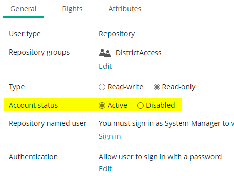

I have an anomaly occurring where random repository users will switch from active to disabled:

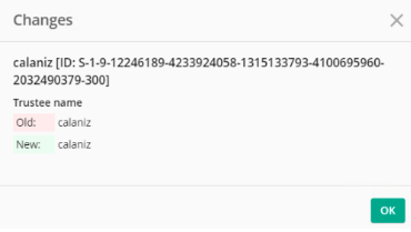

I have spent many hours digging through Audit Trail. One interesting I found is that when the admin goes in to change the user back to and active statues, that registers in Audit Trail as a change to the trustee name. Here is an example:
As you can see, there is no change. The names are the same.

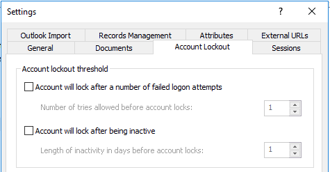

What about failed attempts? At what point does the account become disabled after X number of failed logins? Could that be a possibility?

Hi Chris, Failed login attempts can lock the account if your Repository Options Settings are configured to do so (See below). You can check in the Laserfiche Administration Console.
Also, LF will only allow a user account to have 3 or 4 sessions running at a time. If they attempt to open an addition session beyond that, it could disable the account as well.

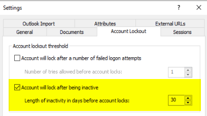

Great tip Steve, thanks! I am inquiring now if these accounts could sit dormant for 30 days which would lock them out.
replied on March 24, 2023
So it turns out it was that these users were locking out after 30 days. Thanks for the assist Steve!
