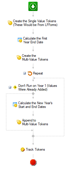

Here's a quick Workflow I put together to test it out:
The end result looks like this:
1	3/17/2023	3/16/2024
2	3/17/2024	3/16/2025
3	3/17/2025	3/16/2026
4	3/17/2026	3/16/2027
5	3/17/2027	3/16/2028
The workflow is attached - you just need to change the file extension back from txt to wfx in order to be able to import it to Workflow.
example.txt (23.14 KB)

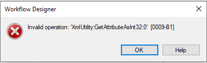

I got an error when attempting to import.  This seems like EXACTLY what I need!  Any thoughts as to what I can to do avoid the import error?
replied on March 17, 2023
I was able to recreate the WF without importing it.  Thank you so much for your assistance!  I completely forgot about the apply value at index feature!
I dunno about that error - maybe Workflow version differences if you are on an older version.  But I'm glad you were able to get it working without importing the example.
