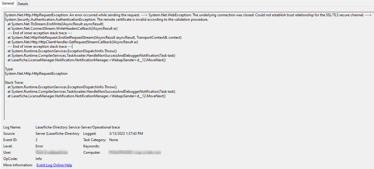

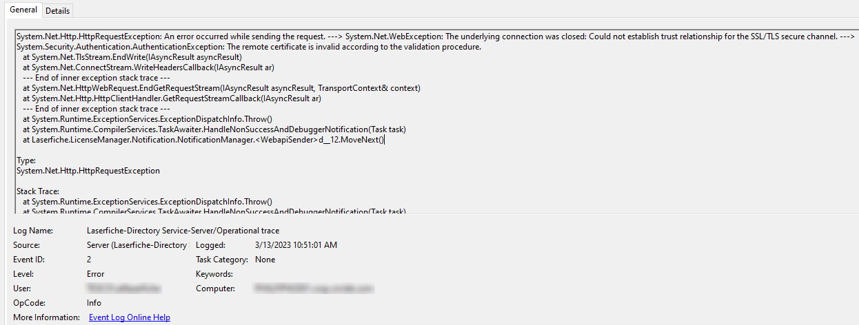

In our LFDS Laserfiche\Directory Service\Server\Operational trace log we are seeing the following error:
How do I find out what certificate it thinks is invalid?

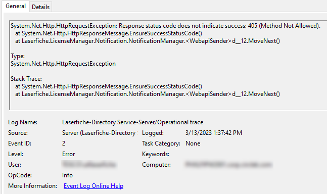

1. The full stack trace was not much longer, but here it is:

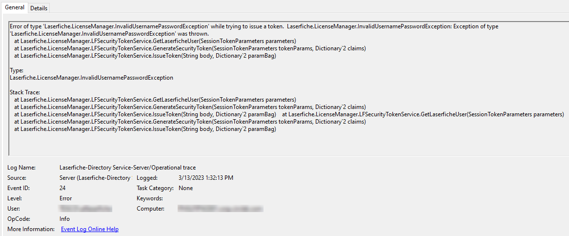

2. These two errors are also seen in the log around the same time.

The first error is thrown every few minutes.
