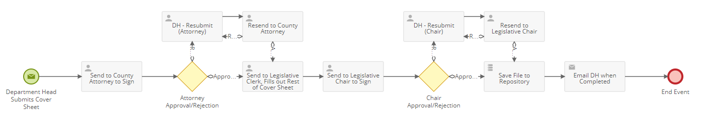

Is there any way I can integrate something like Adobe Sign or Docusign into my form?

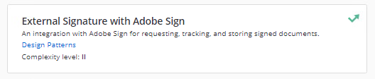

This is the flow so far, and I would like to be able to integrate e-signatures into the “Department Head Submits Cover Sheet”, “Send to County Attorney to Sign”, and “Send to Legislative Chair to Sign” steps.  Now, I’ve seen that there is a process template for external signatures with Adobe Sign but I don’t know how that would work in this case since there are multiple signers for one form.  Any help would be appreciated.

replied on March 14, 2023
An AdobeSign BP was added to Solution Templates for Self Hosted systems. It contains the Forms and Workflows for request a Signature in a Form process and WF making the Webservices calls to AdobeSign for Signatures. Gives you all the pieces, you just need to figure out how to use it what they created with your process.
