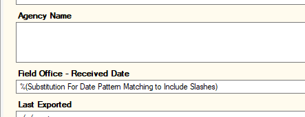

I have an input date of 04122022 and i am using pattern matching to extract the date from a field but i would like to add slashes as the final results. 04/12/2022 to be inserted into a template metadata field.  Does anyione has an example of the pattern match token that can be used?

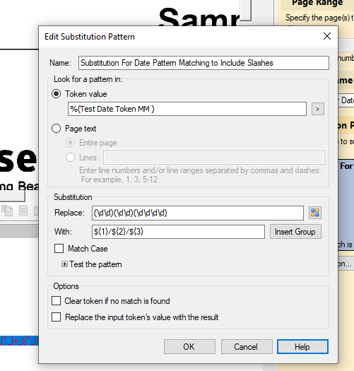

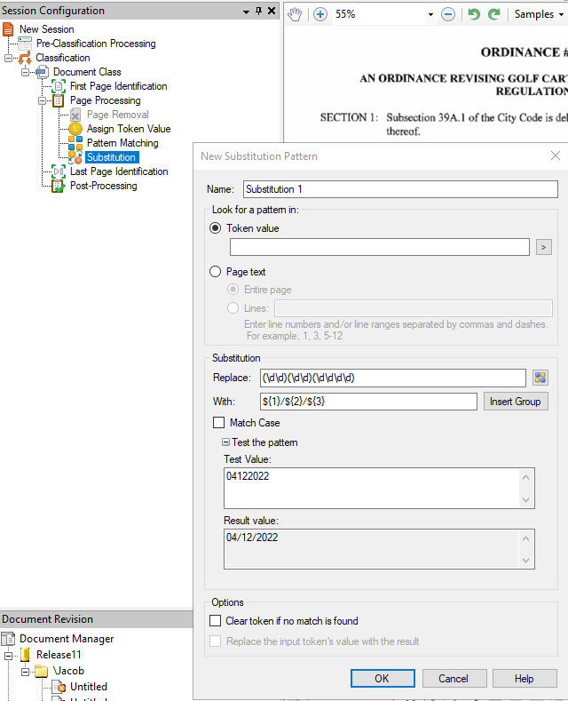

You can use a Substitution process to do this easily:
Pattern: (\d\d)(\d\d)(\d\d\d\d)
Replacement: ${1}/${2}/${3}

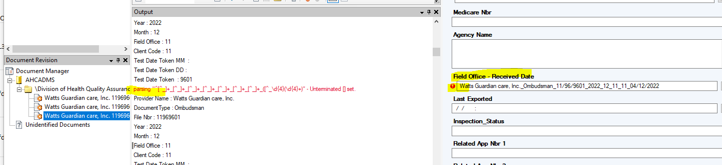

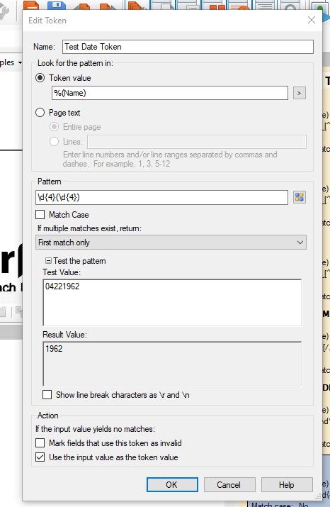

Thanks again Chad for this information.  The subsitution token did work on the date alone.  I hate to keep bothering you nut if you can clear up just a few more things for me.  I am new at pattern matching and regular expression.  Is it possible for you to provide futher guidance on resolving this issue.  I really appreciate your help.
Below is the input data that i am working with and everything works fine up until the date portion.  In my pattern i receive an unterrminated set error.
Test String is  below with the date (04221962) as the last value that i am trying to figure out
Watts Guardian Care, Inc._Ombudsman_11969601_2022_12_11_11_04221962
When I test the pattern, i get the below error message and my template metadata is populate with the entire test string instead of the substitution token.
*** parsing "^[^_]+_[^_]+_[^_]+_[^_]+_[^_]+_[^_]+_[^_]+_([^_\d{4}(\d{4}+)" - Unterminated [] set.  ***

replied on March 8, 2023
Your regular expression has a typo and is missing a "]".  The error is saying that square brackets have to be in pairs and that you have an opening bracket with no closing bracket. In your case, it's the last opening bracket.

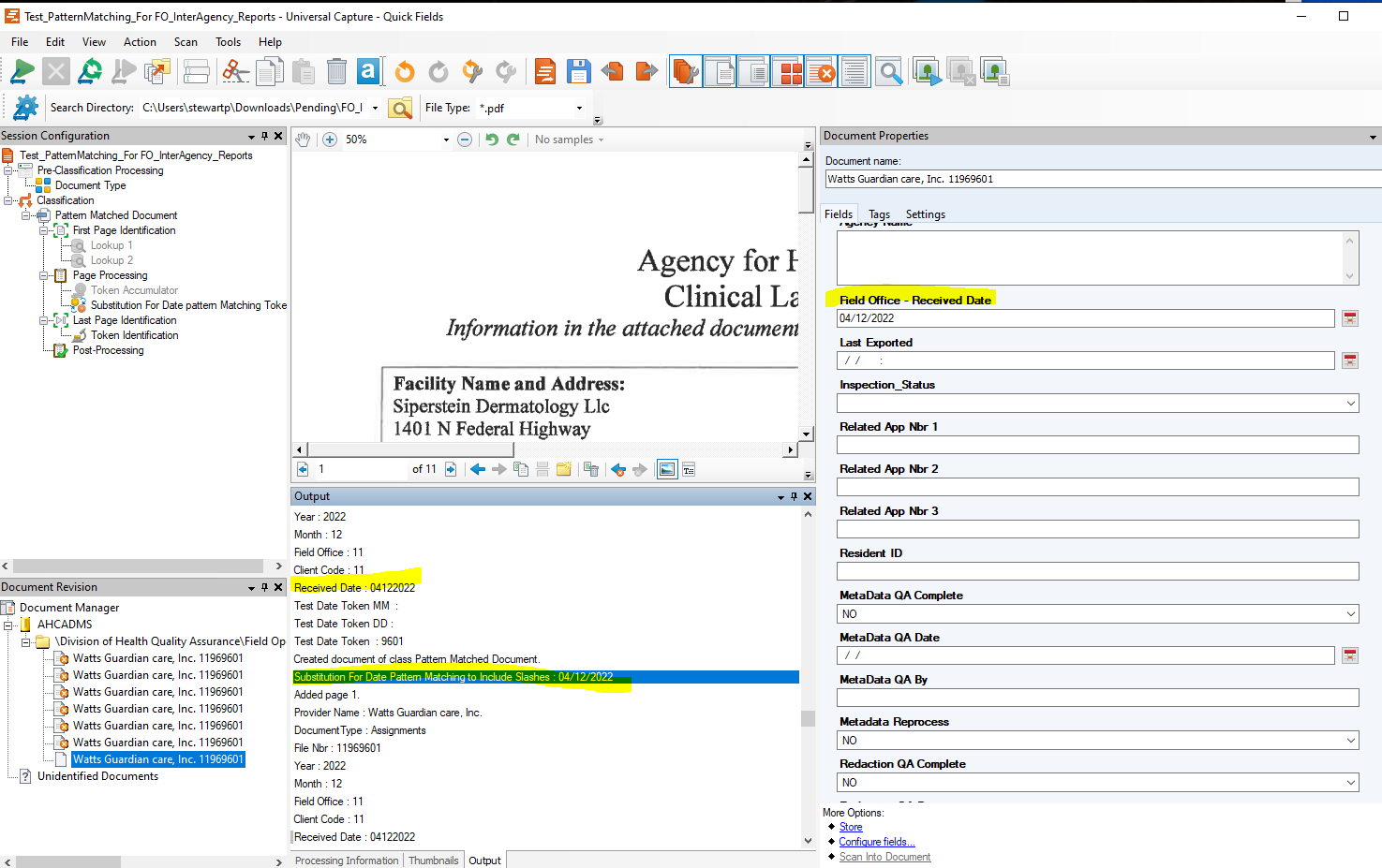

Thanks again Chad for all of your help.  Recognizing my mistake in my regular expression and providing me with the correct expression seems to have cleared up all of my issues.  Using the expression ou provided and the tip about the substitution token seems to have worked.  Snippet below shows the input date that i was working with, the value of the substitution token and the template meta date in it's correct format with the slashes.  I really appreciated your help with this.
