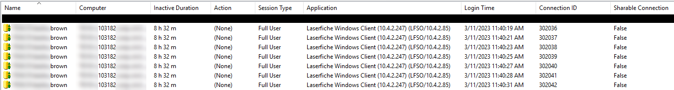

As an example of what we are seeing. the below screenshot shows a small sample of the connections we are seeing. Each colored block is for 1 user.

Looking at this further, I don't believe that the issue is that the sessions are staying open, but rather why is the Web Client creating so many new sessions?
replied on March 9
It's interesting that, if you look at the Red user, most of the sessions were created at about the same time. Do you think that they viewed that many different instances of a Form, or would it have been a single Form that somehow caused all of those sessions to be created?
If the user is opening the Forms in the same browser, the web client should be reusing an existing session. Sessions are identified by session cookies, and the main cause of cookies not behaving the way you would like is related to domains. I would make sure that Forms and web client are hosted on the same domain, all urls use the FQDN, and all pages are https.
From a troubleshooting perspective, if you have a har trace that shows the problem occurring, you would be looking to see if the session cookie used for web client is the same across Forms instances or not.

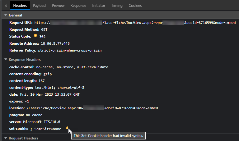

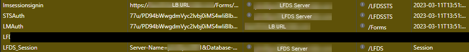

@████████, it looks like you are on to something with your comment about the cookies. I decided to try creating the HAR file again last night. This time I started capturing the data after the new window opened for the task in Forms. I went to the Network tab and went down the Name list line by line until I got to the first Request URL that included /Laserfiche. In the Response Headers section next to set-cookies it says SameSite-None and then a warning symbol. When I hover over the warning symbol it says, "This Set-Cookie header has invalid syntax."
I then went to the Cookies tab and checked the option to "show filtered out request cookies". In the section that then showed I found the cookies where the Domain and Path referenced the vanity URL, LFDS Server name, /LFDSSTS, /LFDS, and /Forms.
When I hover over the information icons for the items in the Domain column this is what it shows:
And the Path column ones show:
replied on March 10
That definitely doesn't look right. Is that problem somehow caused by the iframe embedding? Does it seem to operate correctly if you navigate directly to the web client?

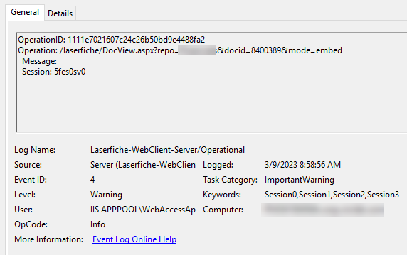

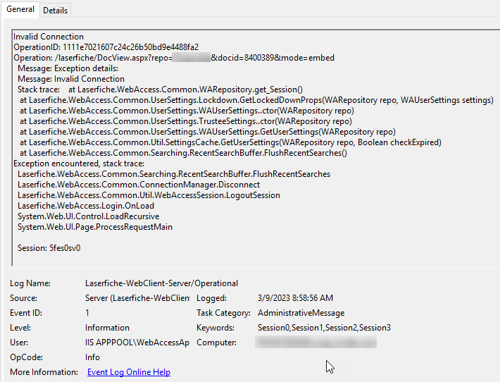

replied on March 9

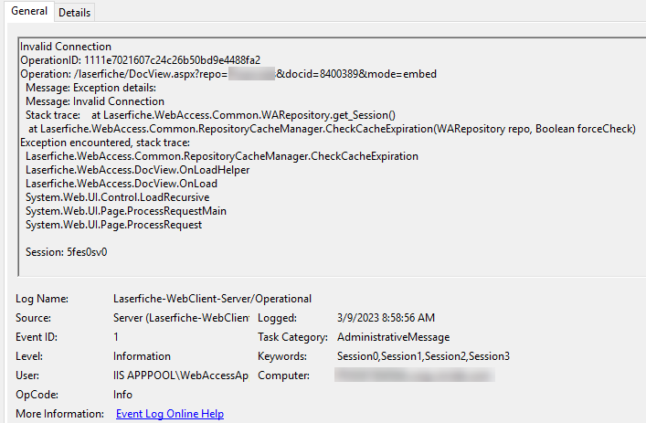

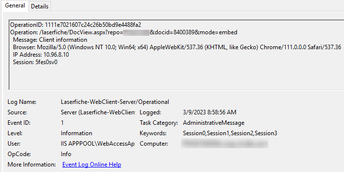

On each of our web servers that has the Web Client installed I am seeing the following warnings and information messages in the Laserfiche\WebClient\Server\Operational logs:
I'm not sure what is causing each of the connections to be considered 'Invalid Connections'.

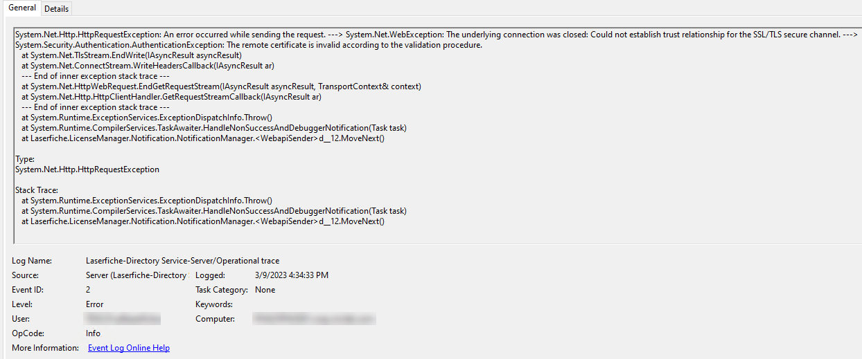

replied on March 9

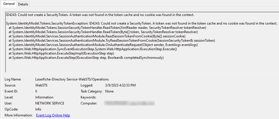

Found the following errors on the LFDS server:
Laserfiche\Directory Service\Server\Operational trace
Any idea what certificate it would be referring to?
Laserfiche\Directory Service\WebSTS\Operations

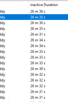

I think this might extend beyond the Web Client. Checking in on things tonight I saw this in the Admin Console:

replied on March 28
I agree I am still getting users with numerous sessions being left open even after replacing WebStorage.dll. Seems to be intermittent / random where I will have a user with 10 or 15 sessions all with the same Inactive Duration. I have even enabled Session Time Outs in the Web Client and Repository but still occurring.
replied on March 30
That looks exactly like what we are seeing. Have you opened a LF Support Case?

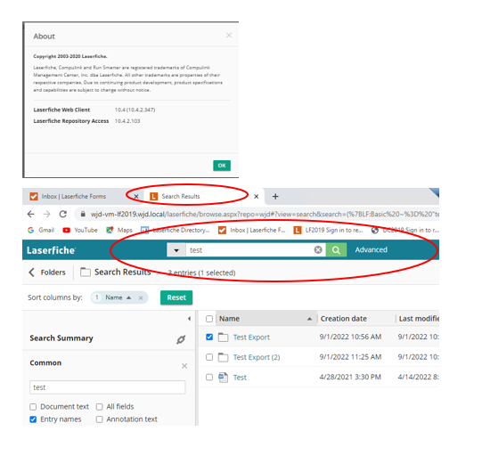

One change in behaviour from 10 to 11 contributing to users opening more sessions is the the Search Tool Bar no longer remains open in the Search Results for reuse. Now users are aware to reuse the Left Panel. However does not explain the random nature of numerous sessions being opened at the same time as shown previously.
replied on March 31
interesting catch about the toolbar. I did not notice that until you mentioned it. What version of Laserfiche Server do you have? Ours is 11.0.0.206
